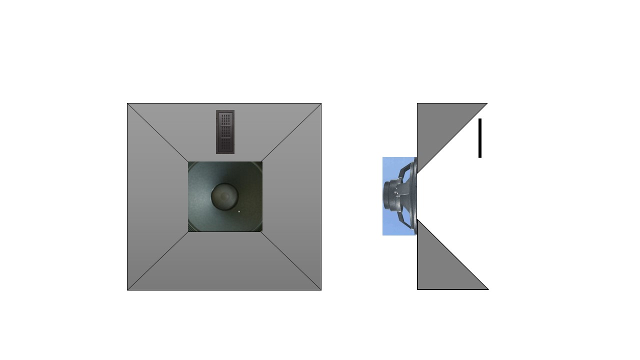

I am thinking of building a speaker with a front loaded horn made of acoustic foam.

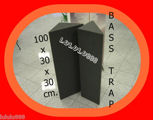

I am going to use the corner bass traps in the picture which I already have. They are 30cm wide and 30cm deep.
IDEA 1
is to put a 15" woofer in the horn ( I have GPA 416s). Woofer can be open back or in sealed cabinet.
Crossed over to a BG Neo8s at 800hz.
Neo8s hanging freely inside horn mouth at ear level (see pic).
Basicly a two way (subwoofer can be added) with Neo8s doing upper mid and treble. I will tweak Neo8s with foam/felt to increase vertical dispersion; no worries in that department. And the drivers can be time-aligned on miniDSP; no worries there either.
What do you think overall about IDEA 1?

Member XRK971 has done a lot of work with foam horns with good result, you might want to look at some of his stuff, or drop him a PM.
he has been working with foam-core board which is a completely different material.
mine is open-cell acoustic foam which is a sound absorbing material.
the idea here is to reduce diffraction and resonance, but still be able to air-load the driver.

Go for it.
Freddyi has some neat pics from frazier (horns and foams).
To me, foam or felt won't do much below 2khz.
I dont think foam can help vertical dispersion.

Its a cool idea. Points for thinking outside the box.
I anticipate it will have very little practical effect, depending on the density of the foam.
It also may be frequency dependent. If you decide to try it, please report back.

I think you'll get too much cancellation with it open backed because the foam will have very little effect at that frequency.What do you think overall about IDEA 1?

Forum member OllBoll have shown that a 50cm wide baffle made of a layer of wool carpet underlay smoothed the baffle peak and lowered the -3db point down to 200hz. The thread is my personal favorite in this forum:
Dipole wool carpet baffle experiment
So I am guessing that the 90cm wide and 30cm deep bass traps can help the woofers down to at least 100hz in the OB scenario.
Even if the absorption/F-B seperation is not good enough, the air-loading the cone function should still work, which would increase the qts and LF extension.
Regarding the vertical dispersion: please read these

well, the idea of an absorbant horn is to address the problems of resonance and diffraction we observe with non-absorbant horns.
i think ollboll's experiment with an absorbant baffle is perfectly relevant.
a sharp baffle edge cause diffraction (rounding-over is used to mitigate this effect too).... however the ripples disappear when an absorbant baffle is used...and all the benefits of a baffle are still there!
i am expecting the same with an absorbant horn.

My first comment is that the horn that you are proposing will not load the driver to 100 hz. However, if all you are trying to do is create a different style baffle which lowers the cancellation frequency, then this could work. This style of baffle will avoid resonances caused by parallel wings.
I agree with what someone else has said, which is that the rear wave is more important than the front wave and that you will still have dipole rolloff probably at a higher frequency than what you think. One way to fix this is to create a horn like baffle for the rear of the driver. This will do a lot more to reduce cancellation, and it will load the back of the driver the same as the front of the driver.
One concern I would have is that horns improve the dynamics of speakers, and the foam will dampen the dynamics, so you might gain some benefits at the baffle edge, but loose midbass dynamics (this is why back horn or tapped speakers have little adsorbent material in them). So, while the wool baffle experiment worked well for a flat baffle, it may not work so well for a horn-style baffle where the pressures are higher.
Perhaps another thing to think about or try is to use a hard material for the baffle nearest to the speaker and then a softer material closer to the mouth of your horn/baffle. The classic example of this is speaking into a conical horn. The person who demonstrated this spoke into the conical horn with an abrupt termination, and then wrapped some sort of cloth material at the mouth of horn. Apparently, the improvement in intelligibility was impressive.

a soft baffle extends the LF extension as much as a hard baffle and has the added advantage of reduced baffle/dipole peak and ripples afterwards...
a soft horn would likely have all the pros of a soft baffle aaaaand also increase the qts of the driver...
but i did not want this to be an open baffle discussion; as I have said, the woofer could be sealed too. (or even bass reflex; imagine altec 825 cabinet)
