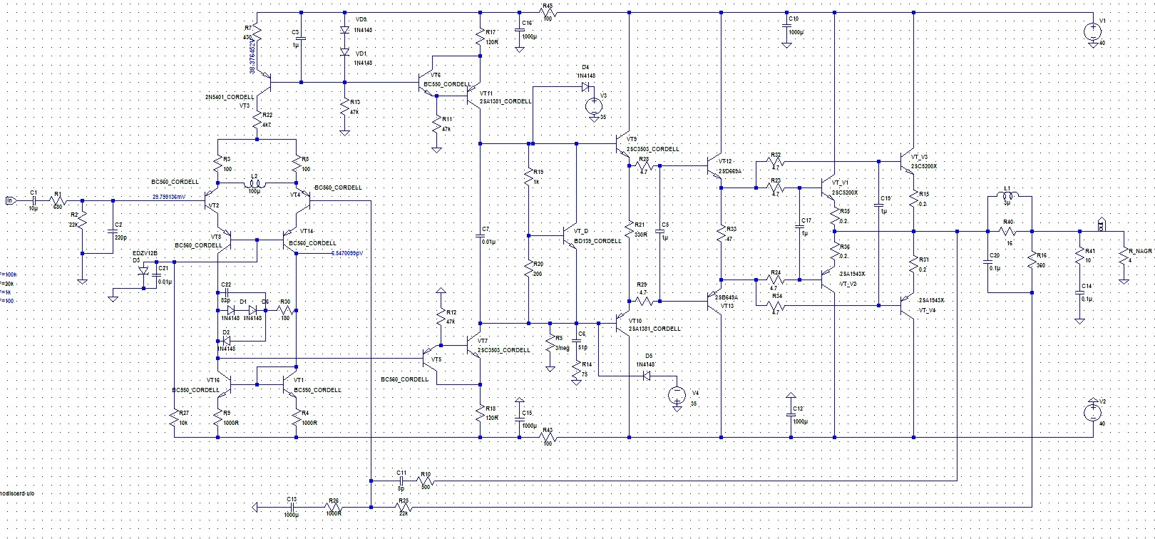

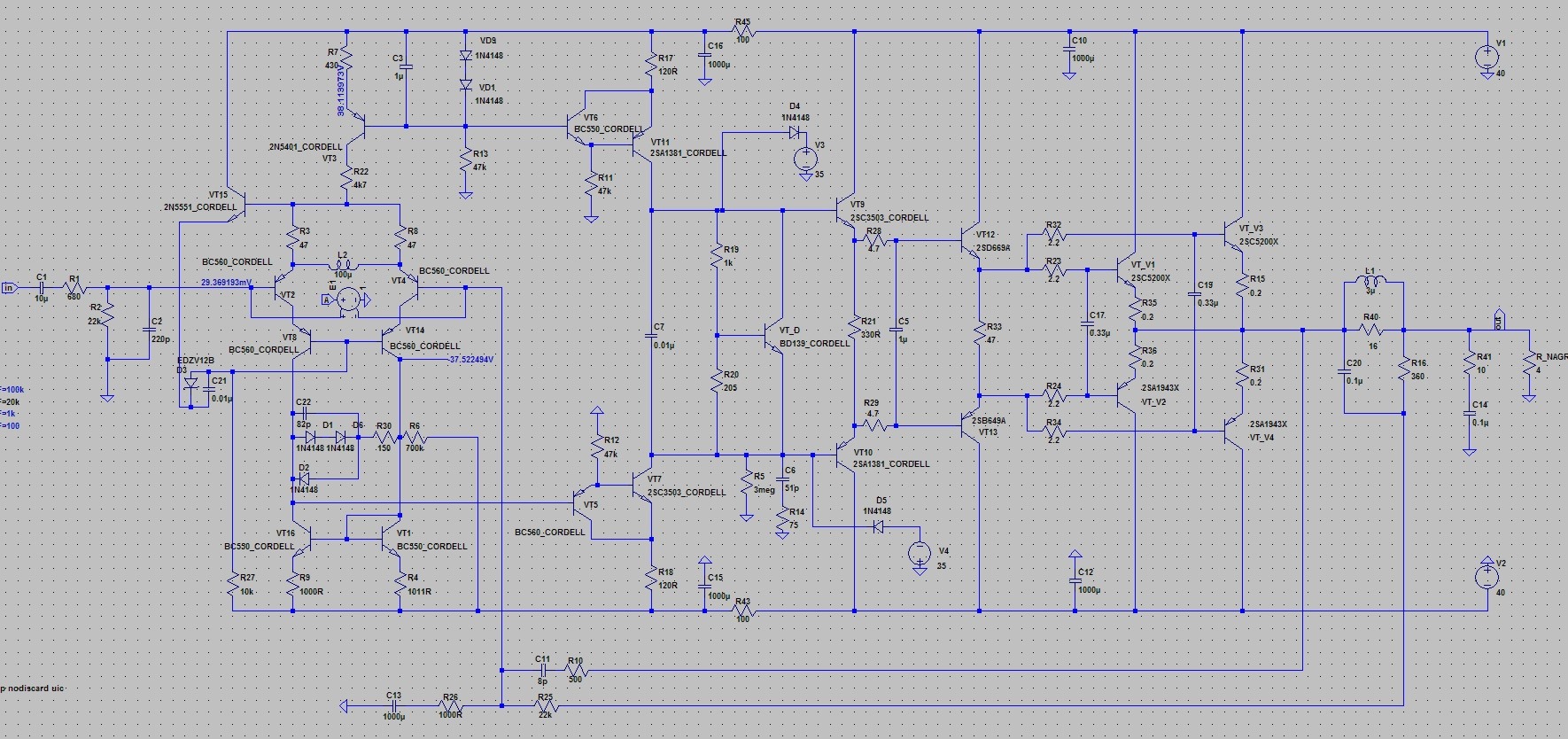

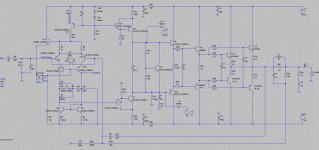

from Apex AX-20 to Apex AX2022 - increasing the linearity of the amplifier

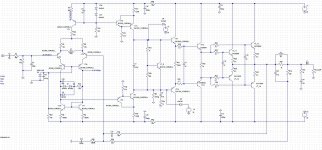

1. original amplifier circuit.
2. after a little tweak Apex ax2022 -)
Seems like it should work? What are your thoughts?

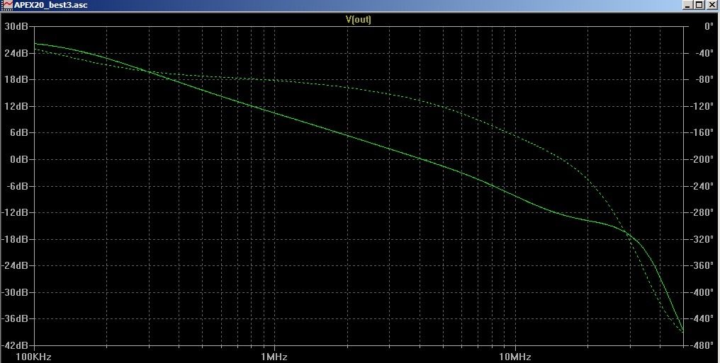

With an increase in the overall gain of the open-loop amplifier, the difference signal of the input differential stage decreases and, at the same time, the linearity of the input and the entire amplifier will be several times better.

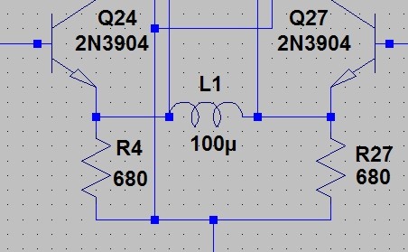

Emitter resistors for high frequency interference will work and will reduce intermodulation distortion.

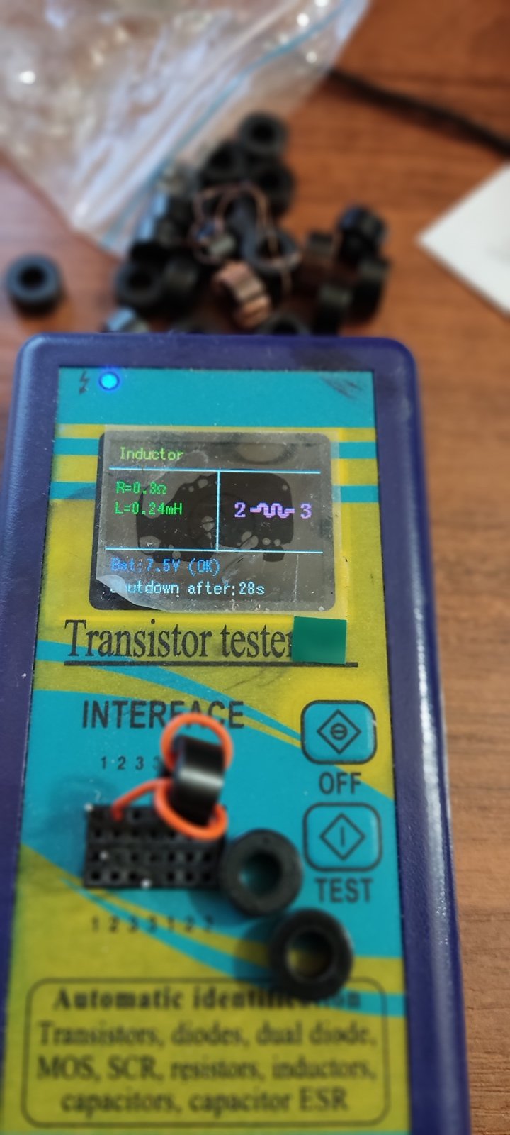

Kramtweeter, You convinced me 🙂. From the coil in this circuit, the effect is only 1.5 times.​
If in other circuits the emitter resistors are larger (470-750) ohms, I believe that the effect of the coil will be 10-15 times greater.

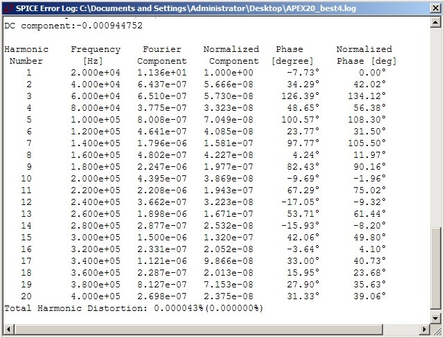

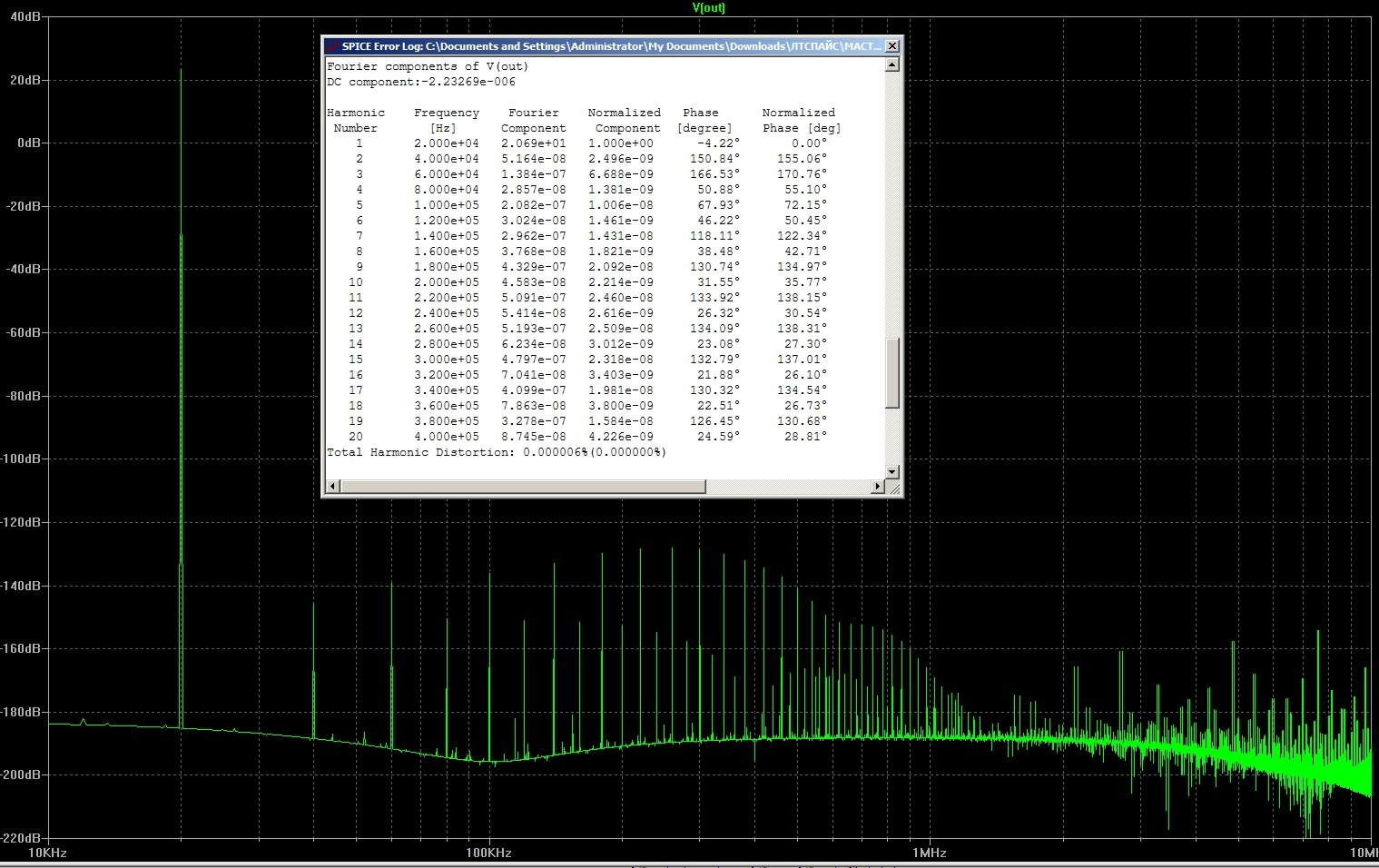

  • APEX20_best4.asc
    APEX20_best4.asc
