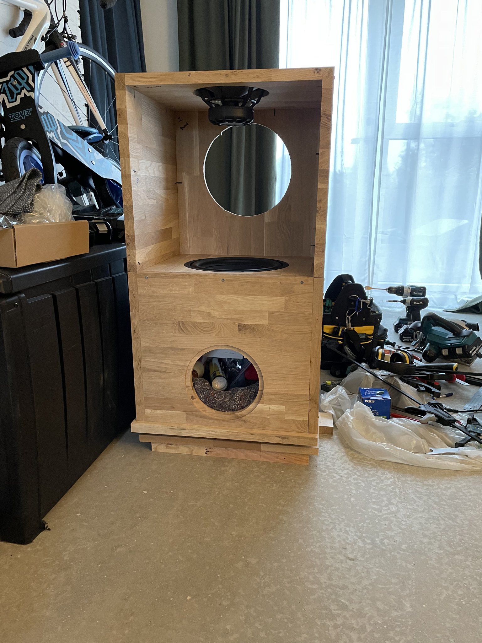

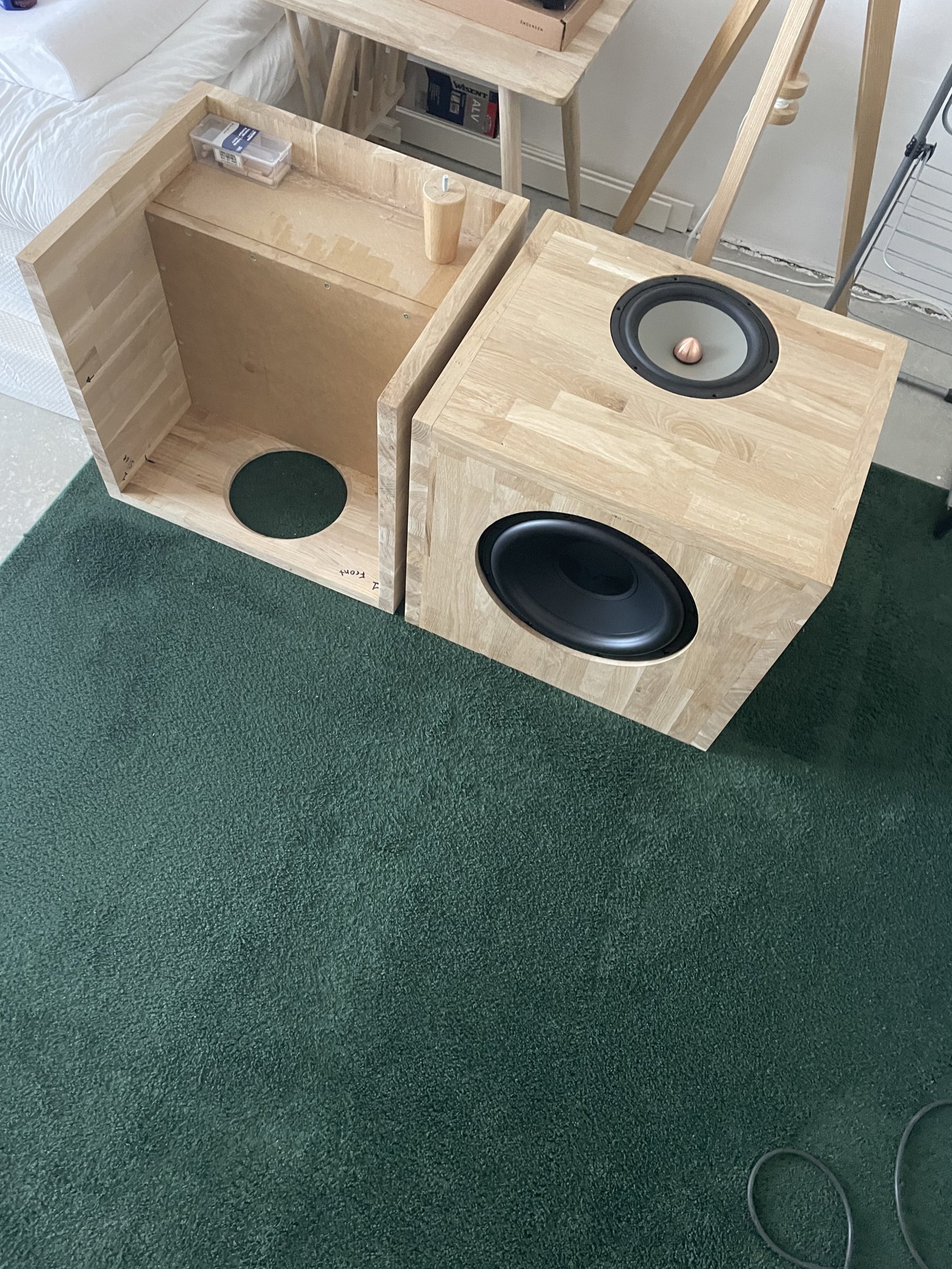

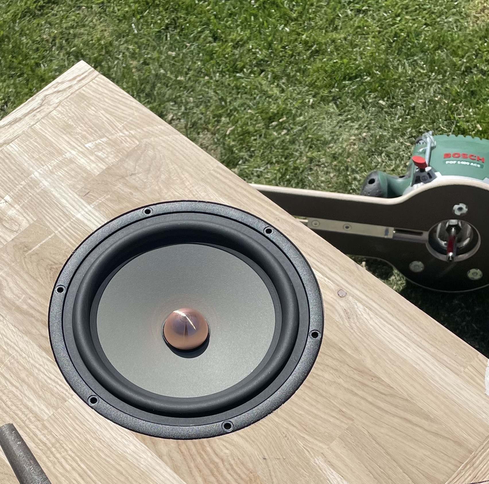

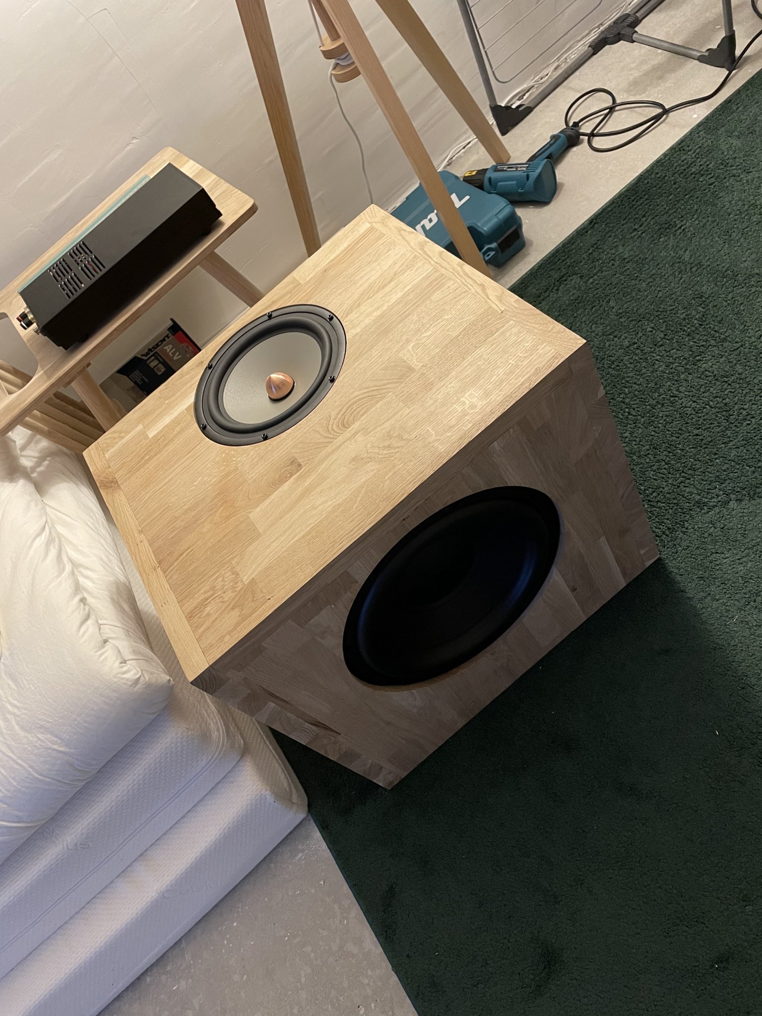

I ended up putting the W22EX001’s in a closed 21L. box and the SVS SB1000 also in a 21L. box. Made the exterior of 26 mm. oak and 22 mm. MDF on the inside.
They are heavy as fu… And they sound absolutely awesome, way better than before. I attribute this to 1) cabinet quality and 2) the W22 combo. Currently I’m crossing at 70 hz, but I’ll do some tweaking when I find the time to do it…
I’ll post some photos of the finished boxes - just need to do the front grilles, but I just need a little more practice on gluing the fabric, before I do it on the finals fronts.
Meanwhile some random pics…
