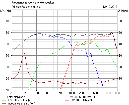

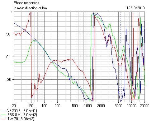

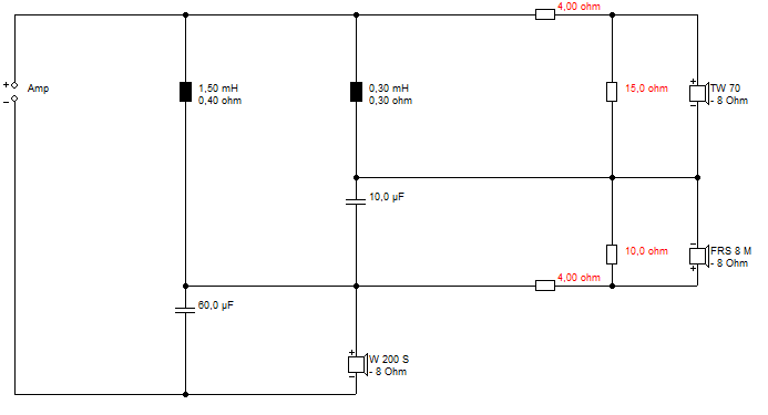

Usual frustration for people interested in series crossovers here! A BIT SHORT ON DETAIL. 😀
I'll lay it out for you. Bud Fried produced interesting 2-way and 3-way series filters for well behaved drivers, often polycones. I give you a typical schematic of a 3 way which I simmed in Visaton Boxsim based on a Fried XO topology. It's very valve and SET friendly and has excellent phase alignment. 4 ohms is no worse than most 3 ways.
I modelled this one on a flat baffle, but Bud Fried frequently time aligned with sloped baffles and used transmission line loading. Polarity of drivers will of course be affected by time alignment. You get what you get. Bud Fried was a very talented man IMO. 😎
