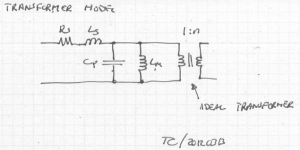

Can you elaborate a little more on how you did this? I have a HP 4192A analyzer at work and have run sweeps on a few transformers. One transformer from an old hifi that used a quad of 6V6s looked pretty bad, only had midrange.
Any transformer can be modeled as shown in attached image. All components have been transformed to the primary. From a modeling perspective, it doesn't really matter if the parasitics are on the primary or secondary side, and when measured, they're all lumped together on the primary anyway.
Rs is the DC resistance of the windings.
Ls is the leakage inductance - basically, the inductance of the primary, secondary windings had the core been an air core.
Lm is the magnetizing inductance
Cp is the inter-winding parasitic cap.
The transformer on the right of the model is an ideal transformer. I.e. K = 1.0 and 1:n turns ratio.
n can be measured by counting the turns (if you're building your own tranny) or by applying an AC voltage to the primary and measuring the secondary voltage (CAREFUL!!). The turns ratio, n, is then Vsecondary/Vprimary.
Measure the impedance of the primary circuit with the secondary shorted. This yields Rs and Ls (Cp, Lm are shorted out by the ideal transformer and the short on the secondary).
Measure the impedance of the primary circuit with the secondary open (or loaded by a very high impedance - 10 MOhm for example). This gives you Cp and Lm (in series with Rs, Ls but as Z(Lm) >> Z(Ls+Rs) you mostly measure Lm||Cp).
On the 4194A, I use the Equivalent Circuits function (MORE MENUS -> EQV CKT). Circuit B ((Ls+Rs)||Cp) seems to work pretty well for these measurements.
