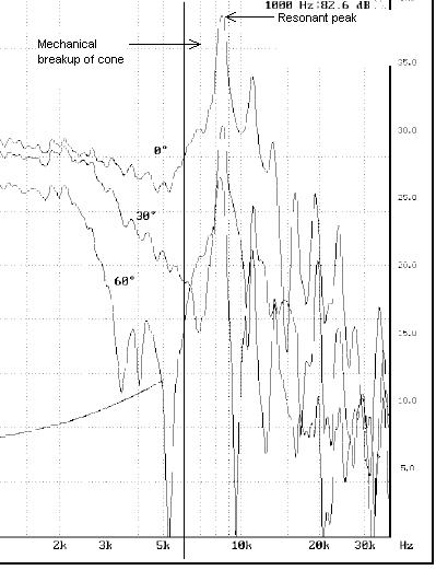

The image below shows part of the frequency responce of the bass driver from the Froy (15cm Magnesium alloy driver) - I have marked on it a line to the right of which you can see severe cone breakup and a large peak where one of the cones resonant modes is excited. The crossover for the Froy makes sure there is sufficient attenuation to the bass driver at this frequency that this has no effect on the sound from it - imagine what the speaker would sound like driven with a full-range signal with that frequency response!
Also note that there is a large difference between electrical and mechanical resonance - the electrical resonance of the driver occurs at a much lower frequency and can be seen as a peak in the impedance graph for the driver. This electrical resonance causes other problems - for example it complicates the design of the crossover (if a passive crossover is used) and a circuit called a notch filter is used to remove the effect of this electrical resonance.

looking more closely at the graphs; I'd say that the trym/froy graphs are more noticably 'squiggly'/'bumpy' than the odin/thor.
I.e. In the Odin graph, the response is pretty 'flat' between 500Hz and 3Khz.
The trym is quite bumpy between 200Hz - 1Khz.
Is these bumps a significant(noticable?) indication to the sound quality?
Or should we just care about those major resonant peaks/dips?

What about the the huge dip just before the line?
