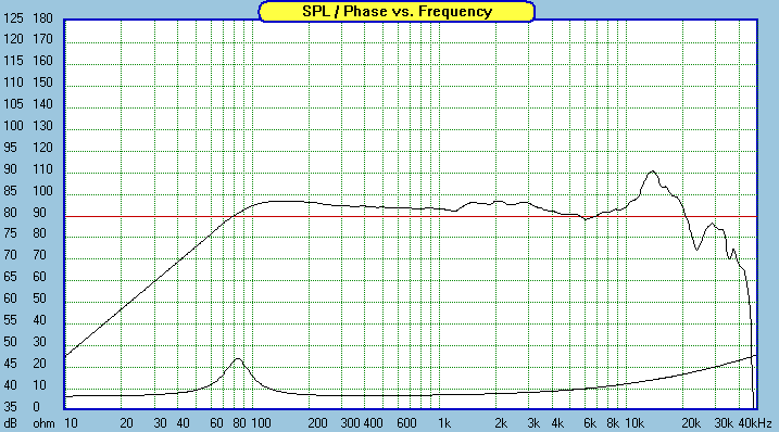

Here's what Zaph says:
"This is a great performing 3" driver. The frame is a very nice casting with better than average ventilation. Very smooth, wideband response. Copper appears to be used in the right place in this motor, for very low distortion and no inductive rise. Could be used full range with a breakup notch and a shelving BSC filter, but would be even better paired with a cheap neo tweeter. The cost is not that low for a 3" driver, but considering the performance, value is still very high."
See http://www.zaphaudio.com/smalltest/
Also see graph:
