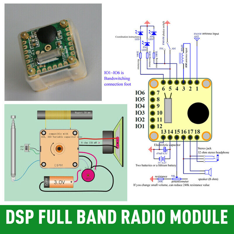

The old radio suggestion is a good one, if you don't mind the size. If you rather want something small and inexpensive with analog controls, search online with the following keyword "DSP Full Band Radio Module". You should find references to the DSPM1 and DSPM2 modules. They have the same system on chip inside, but mechanical mounting and pinouts are different. Documentation is available online. It is a module from China with mechanical tuning control. Just turn the knob to your desired frequency. This module is sometimes installed inside tube radios to make them "work" without doing a electrical restoration, or to add the FM band. A mechanical coupling from the encoder shaft of the module to the dial string is needed.

I have one of those DSP modules, but I have not used it. I thought I was getting the "big" one, but I received the "small" one for which there is little documentation / online experience to draw on. I'm not sure the two modules are identical in function. So going that route may be a bit of a crapshoot.
