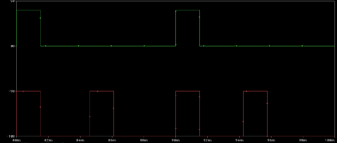

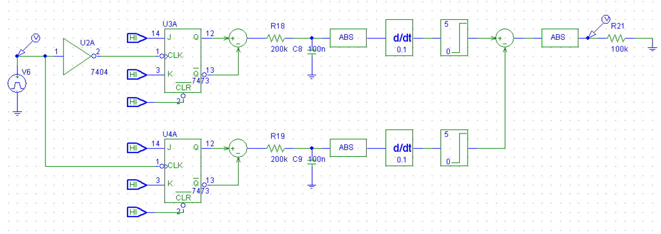

One more came to mind:
1) Split the input pulse train into two streams of 50% duty using two flip-flops.
2) Integrate (using first-order function, not accumulate) the two 50% square waveforms to triangular ones (difficult at low frequencies).
3) Take absolute values of the triangular waveforms to double the frequency.
4) Differentiate to square-wave back again.
5) XOR the square waves to get the pulse train.
Apply tp/2 delay and XOR to correct the duty.

Please note that the following is approximate, as the integration does not yield a triangular waveform (linear ramp), only close (slow exponential).
