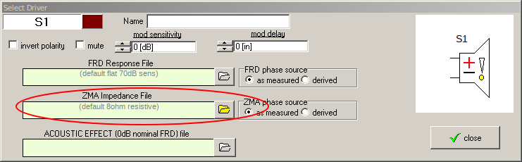

I saw this option, does it mean one have to use a tool to capture the measurment of the driver from a mic or tool like the Dayton driver measurement thingy ?
Vifa AC25SG05, but how do you generate this impedance file ?
Thank you AllenB, there is no real needs so please don't waste time. It's more about to understand about such R//C in serie behavior on the frequency curve. So I undestand the resistor is about the spl correction, but I just don't understand the C value which is I assume to be the starting corner of the climbing frequency... Maybe if I enter the C value in a first order on line calculator it may give the frequency where it starts ? the low end being the tweeter high pass filter before this serie R//C?
Or learn to generats such files for this smart Xsim soft... I'm about to dig out threads about it, how to or manual if exists.

... too bad it's not as simple as choosing an average nominal imedance on a datasheet or the voice coil Z...perhaps if the impedance curve was flat...
You haven't shown your schematic. I guess that it is interesting what frequency the capacitor equals 1 ohm as well.
You can use a program to trace it for you, or you can type it by hand into a text editor while looking at the plot.how do you generate this impedance file ?

I measure impedance by connecting a speaker to my soundcard/computer. Nothing to buy. Just some wire and resistors. Free software is some of the best measurement software. Just saying..the price
oh I see... thank you for the tip,
I have to dive in Arta or REW manual...if they are the ones you refer about? I still have to find time to RTFM... I definitly have to. Not aware they can do such things.
Both of those will work. They don't do it for you, you have to do it manually.
For example, run your amp into a 1k resistor in series with a 10 ohm resistor. Plot the Voltage across the 10 ohm resistor vs frequency. Set the level so it measures something like 10mV. Replace it with the speaker. Trace the plot. Derive minimum phase.
