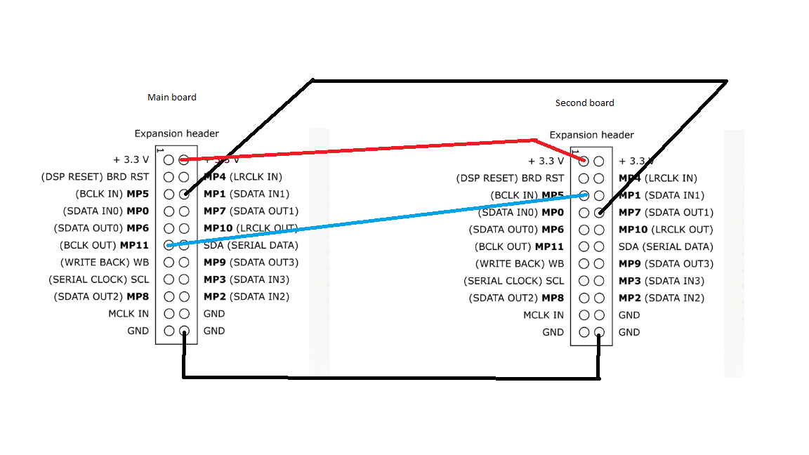

Hi.
I have two freeDSP classic modules.
I connecet them by attached schematic.
My idea is to use first freedsp as main DSP. The second one as ADC converter for more analog inputs.
Į connected 3,3v to 3,3V;
GND to GND
SDATA out1 from secont to SDATA IN from main board.
BCLK OUT from main to BCLK IN to second.
the clock jumper from second board is on external mode.
sigma project configured. But i have no CLOCK on second board.
Can sombody help me? Maybe i connected wrong pins? How sinchronise boards on the same CLK?
