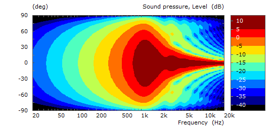

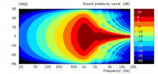

To get started, here's some results created by Richard Taylor with Acousto (AcouSTO - Acoustics Simulation TOol - Homepage)
Data taken from Taylors site here: LX521 Simulation: First Steps | Richard's Stuff

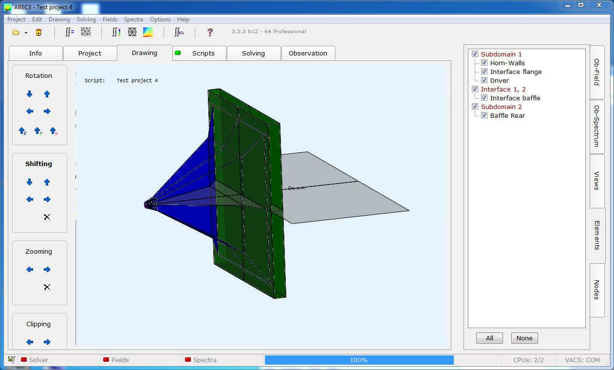

Kessito, great tip about Excel. I dissected the H400 example, used all the elements from there, but replaced them with my spreadsheet outputs. That exercise made me understand a bit more about how Abec3 works. Note: A bit, not a lot. 🙂
attachment.php
I next step would add the midrange entries to the Node structure. It should be doable, as they are on a flat surface. Just more time consuming than drawing it with a mouse.
Question: The example uses a lumped element model of a compression driver. The output of this is transferred to the BEM model via the Driving section in the solver. I understand that the output from the compression driver itself through the horn takes into account the small waveguide buiilt into the driver. I´m not sure, however, how that would work when I add midrange drivers to the horn sides. In other words, will the reflections from the midrange drivers bounce off the element "one can see" in the model (BEM only), or will they go deeper, into the compression driver (in the LEM model) before they bounce back? I suppose what I am asking is if I should remove the "compression driver waveguide" from the LEM-system and rather include it in the BEM system to ensure that the midrange radiation gets reflected from the right point.

In the H400 example, the following are used:
1. An "edge" around the horn mouth, with normals pointing away form the horn throat)
2. An interface baffle, extending out from the edge in 1), and "closing the horn" (i.e. normals pointing into the horn space).
3. The driving element seals off the throat of the horn.
And there is also
4) A baffle rear, with the size of the horn mouth (but shifted 1mm towards the throat), with normals pointing towards the throat.
Aparently 4) is a trick to avoid creating the outside of the horn.
So it seems the horn boundaries are well sealed off through 1, 2 and 3. If you could explain how 4) works, I would be grateful. I also don´t quite understand why the five-sided bounding box ("Interface baffle") needs to have volume and not just be a flat element separating the sub-domains.

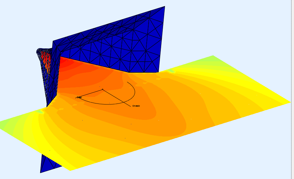

attachment.php
EDIT: Didn´t quite understand your second sentence - could you please elaborate?
EDIT2: Any explanations about how BEM works are very welcome! 🙂
