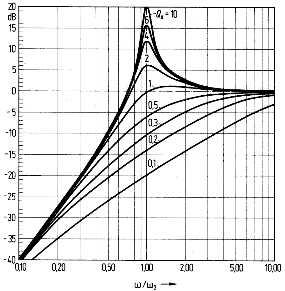

This is the Qts-induced roll-off (around Fs) of the driver in infinite baffle:
The-x axis is divided into multiples of the drivers Fs: 2.0 is double Fs, 0.50 is half Fs etc. You can easily see how a low Qts driver rolls off at higher frequencies than a driver with Qts=1. The 6dB dipole roll-off has to be added to this.
Answers everything and ties it in. Thank you.
