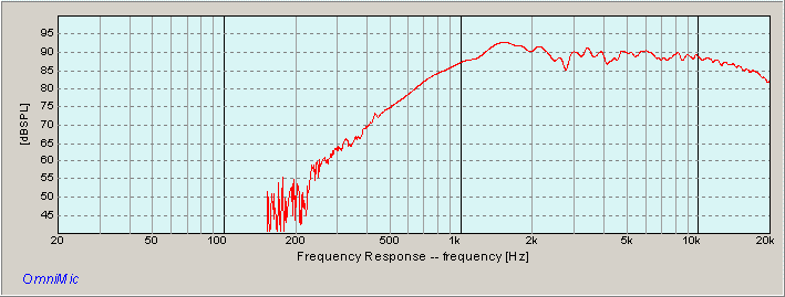

This may help.
The FR is with the tweeter mounted onto a box with a baffle width of 10".
