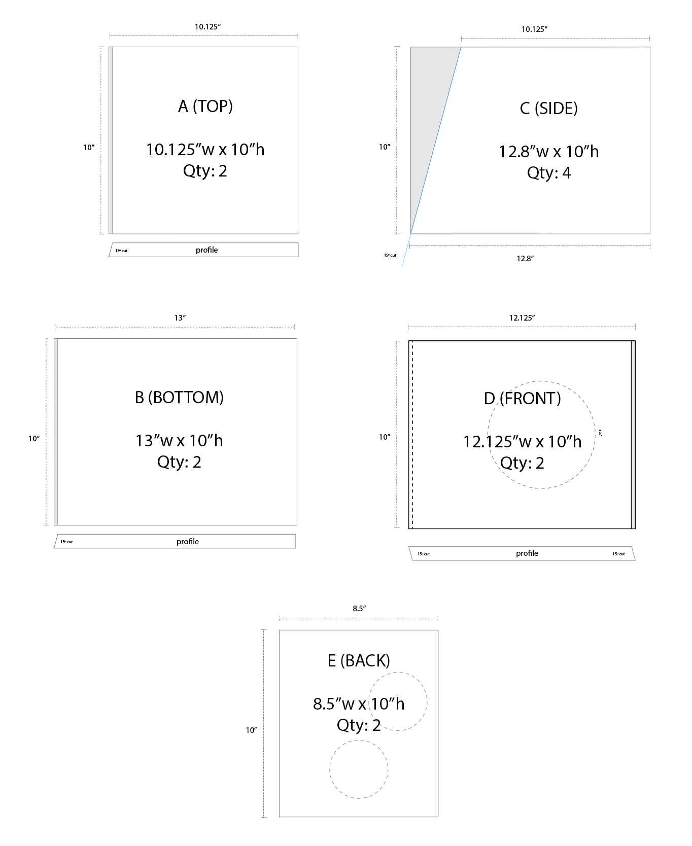

I'm finalizing a small bass reflex box design for a single full range driver. I'm at around 0.45cf right now, but can adjust as necessary to the right driver. This is my first endeavor into full range and I don't have experience with many of the brands that I come across in my research. At the moment, I've narrowed things down to the Audax 6.5" 17LB25ALBC or a Markaudio Alpair. I've attached my drawings. I'm limited on where I can place these, so they'll be a little below ear level, hence the 15º tilted baffle. They'll be replacing KEF Q100's.
All in all, hoping for recommendations for 6"-8" FRD's in the $100-200 range and any feedback you have on the enclosure design itself. They'll be driven by a Pass Aleph 30, and I'm hoping for a sensitivity at or above 90db. Primarily listen to jazz, earlier rock, some indie rock, and chamber music.

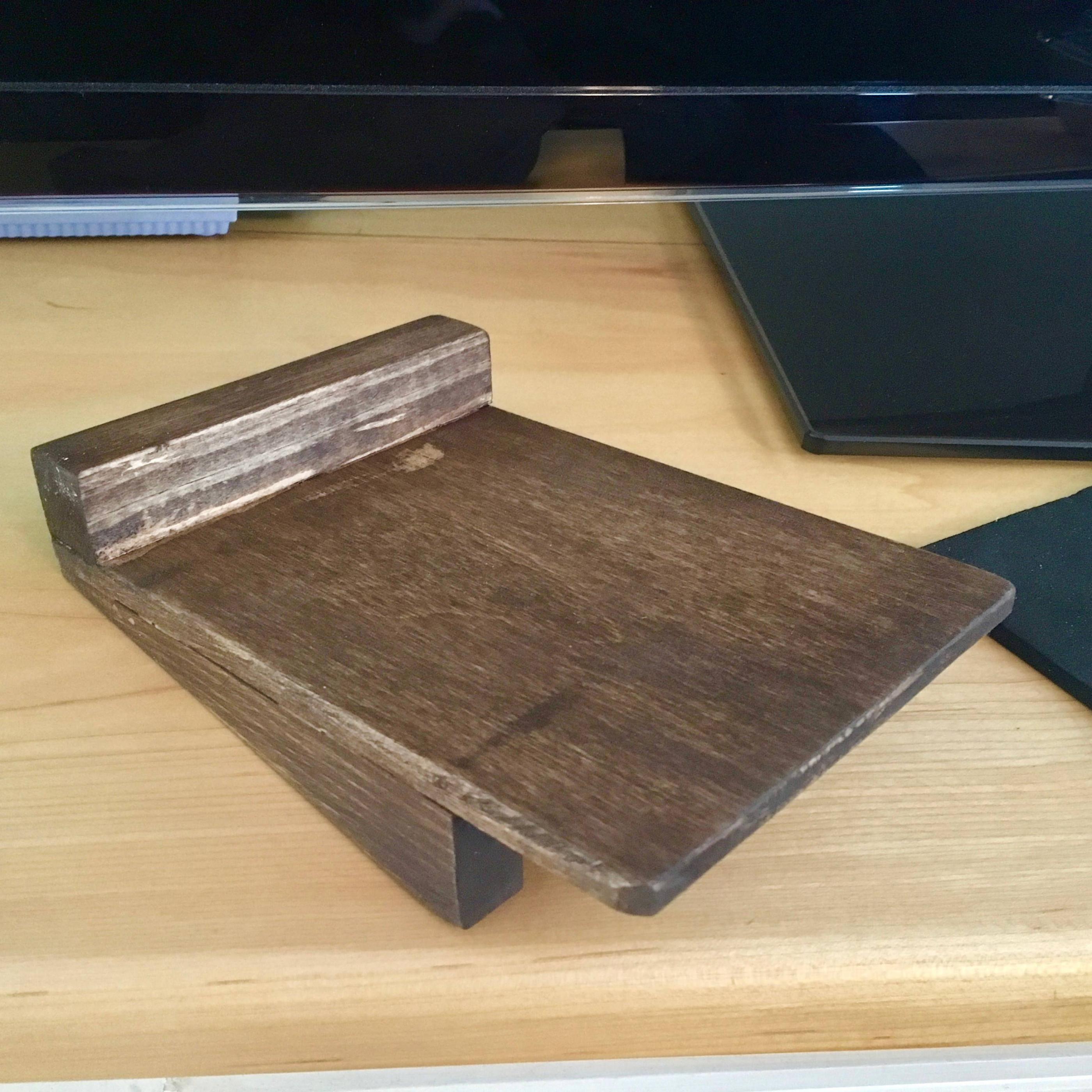

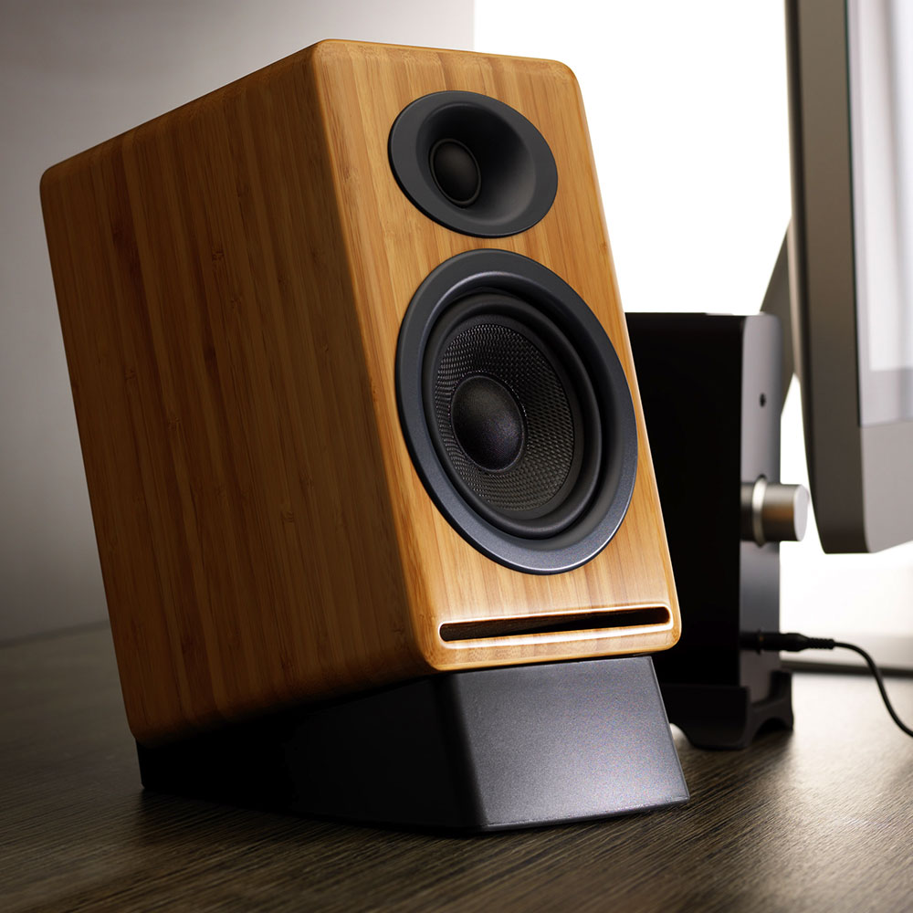

Instead of tilting the baffle, you can also go for desktop stands that will tilt your speaker. That way you can keep the speaker baffle straight, and have more flexibility on the tilt angle. Some images taken from the web attached to give you the idea.
With the Aleph 30 you should be able to drive any of your choice of wide-band drivers to loud levels.
Those are really nice. Unfortunately I have some height restrictions too. Most of the wedges I’ve found are too tall for my space. It’s essentially a 14” cube with no front or back. Not ideal placement, but the only option I have until I buy a new house or my wife becomes more lenient on speaker placement 🙂

… a small bass reflex box design for a single full range driver. I'm at around 0.45cf right now...
0.45 ft[su]3[/sup] = 12.74 litres. I’d call more like medium size. Samll is 2-5 litre.
Without thinking too far afield, this volume works with A10.3/p, Pluvia 7 and Alpair 7ms.

...driver size. Sounds like I may need to look a bit smaller than the 6-6.5”
I think the FF165wk will fit that small a box, but if you squeeze a bigger driver into a smaller box it can start to lose some openness. But <10 litres would be small for this (optimum miniOnken is 17 liters).
You do not want a box that has the side walls to close to the driver, which can cause shoutinesss.
Alpair 10p is one of my favorite drivers. It measures 90 dB, and with its greater excursion can do more bass than the larger FF165, and is smoother. The A10.3 is as good with slightly different compromises. In my alignment 13 litres is optimum.
Note that each different driver will require a different vent size. And you might find 15° an excessive tilt. I did front, 10°, and 15° baffle versions of the microPlus for FF85wk (yet to be drawn for Alpair 5.2/3.
