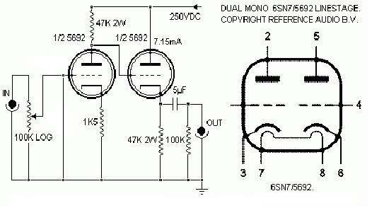

Better post the schematic.

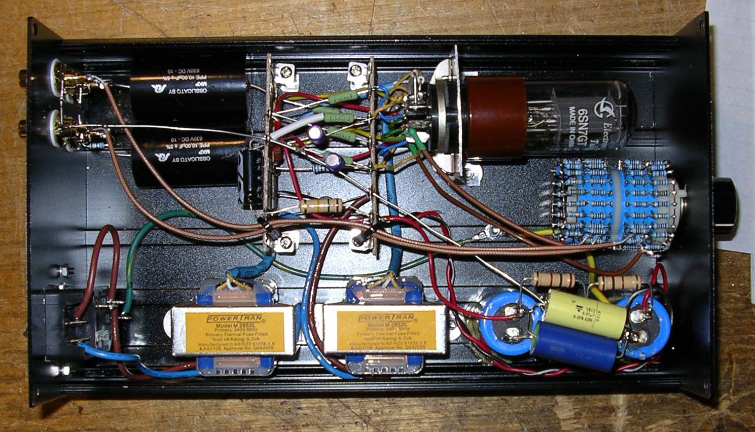

Schematic attached, however I've made some changes because I think when this line stage was designed it was to run the line pre into a SS power amp (hence need the cathode follower to give a low impedance output). But seeing as my power amp is 100k inoput impedance, I took out the cathode follower and now run the line pre as a plate follower (to lose any dreaded cathode follower effect). Plus it also meant I can take out one of the valves, so the load on the small power transformer is halved. I've wired the valves so that this can be quickly done (one valve shares the two plate followers, the other shares the two cathode followers).
I've also put a picture of the build prior to removing one tube and modifying as follows (not sure how clear the wiring is in the pic):
(1) Removed the bottom tube from its socket.
(2) Removed the two (green) wires from the plates of the top valve going to the grids of the bottom valve.
(3) Removed the two 47k resistors going from the two output caps.
(4) De-soldered the (yellow) wires running from the two output caps to the bottom valve cathodes, and re-soldered them to the junction of the (blue) wires and the top valve plate 47k resistors.
After changing it I have noticed the following; (1) gain appears to be slightly higher, and (2) the buzz is exactly the same. Taking out the 10uF output caps removes all the gain, and the buzz - but I can't work out why this is the case. Clearly the aim is to have no buzz, but a decent amount of gain (theoretically it should be about 10x).

You should draw out your new schematic even by hand and post that - your description is hard to follow!! Would encourage more responses.....
And while you're at it - also draw in the PS as you have it done too....

From your description, it sounds like you have simply removed the CF - not converted the stage to a plate follower. You take output now directly from the anode of the first stage - this is a common cathode amplifer with cathode degeneration, not a plate follower. It will have high output impedance which means it will not ground any hum picked up on the interconnect. However, you say that removing the output coupling capacitor removes the hum (and signal too, of course!) so the hum is coming from the circuit rather than the interconnect.
The most likely cause of your problem is poor grounding. You are probably injecting charging pulses into your signal ground. I can see a bare ground wire arcing across the amp, but a picture does not give enough detail. What grounding scheme have you adopted - star, bus or some mixture? Exactly how are the negative ends of your smoothing caps grounded? Where does the ground wire attach to incoming signal ground and safety ground/chassis?
