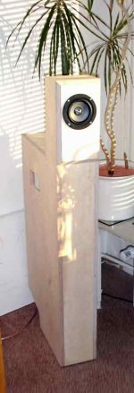

I'm almost as familiar as Dave with the combinations of enclosure/drivers discussed, and have some observations to pass along:
Mileva:
with an appropriate driver, and if you have the wall space available, I think it's safe to say the Mileva wouldn't require BSC of any sort. It's width/depth ratio can cause some placement issues in regards to toe-in for imaging sweet-spot.
Micro-tower:
If budget permits, the dual driver "castle" version would be my recommendation - I'm running a pair upstairs with a cheap Sony 23W or so receiver. The up-firing second driver adds a lot to ambience/dimensionality, and their small footprint makes placement fairly problem free (unless there is a low overhanging boundary shelf/counter etc.) - certainly more so than the bipole version.
They can definitely produce bass if corner mounted, but with the potential of some boominess, as well as exaggerated separation if more than about 8 ft apart. In my case, they are a couple of feet either side of a couch, and angled towards the main listening area, and sitting on 12" squares of granite (countertop sink cutouts).
The current availability status of the Fostex FE127E is a bit of a bummer for those of use who've found it a "go to" driver for the past 5 or 6 years, but we'll adapt - maybe we'll even find our own new "it" driver.
The late (and perhaps not all that lamented) Hemp Acoustics' FR4.5 was an interesting little driver - definitely a different flavor, but still fun.
