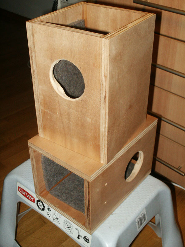

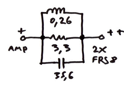

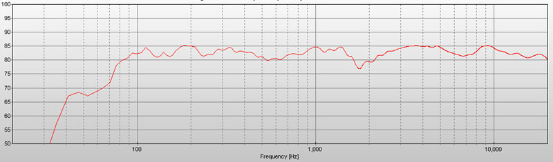

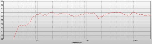

Hello,
I built a pair of 26x16x16 cm boxes out of 15mm plywood and arranged 2 Visaton FRS8 parallel connected bipole (push push front and back). The driver centres are 10 cm down from top.
The sensitivity is 85 dB SPL for 2.83V @ 1m. They must sit on stands with their front baffles 60cm from back wall for best balance. I had to use a notch to cure an octave band forwardness from 1.5 to 2 kHz. I built, measured, and listened carefully to about 12 notch filter combinations. When I finalised the notch I got excellent results. The best thrill I ever got from listening to a small quality speaker (wait for 48hours for treble to open up, if the drivers are virgin). The Visatons are 15 Euro each so you can understand what I will recommend over a BBC for a small nearfield... Funny is that the result is far more exciting than a BBC too.
The Visatons go well for bass down to 80Hz arranged as such. I am posotive that the sound without notch is far inferior to the notched speaker. I am looking to experiment with TB W3-871s and I would like to know if anybody has experience from FRS8 and TB to tell me how do they compare. I am thinking of ordering a TB quad. Added sensitivity would be much better but I have seen diyers measurements of 82dB instead 87 TB says...

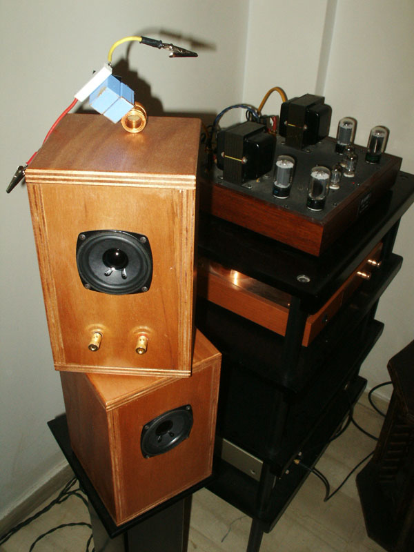

Pics
Some pics here. Listened with Gaiclone also. I prefer the 20W PP class A triode valve amp.
Gainclone is amazing value but still with cold ss heart.
The lil speaker is very revealing but it does not judge hard. Tends to highlight the good traits of the various amps driving it. It took the 30W GC (with 500VA toroid) without compressing or hitting stops. The volume was good for the 30sqm space we listened in.
