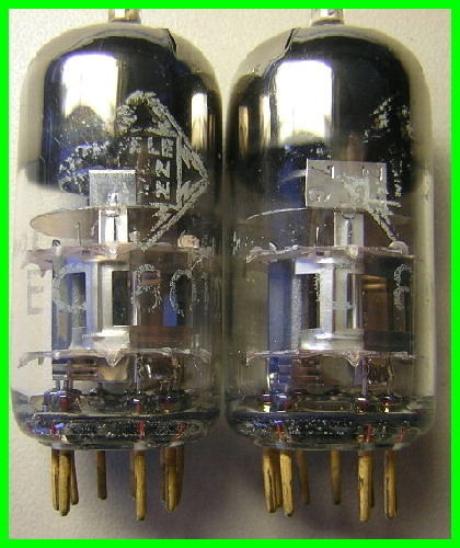

Hi all,
Just found a pair EC8010 tubes on a hamradio exchange market
At the pins I can see they are used, they look ok though.
I haven't tested them yet, hope they are ok..... 🙄
Did a search on this forum and got lots of threads with EC8010 in them, but they all appeared to be someones nick :xeye:
Found data sheets plenty, but like to know what was their intended use and in which diy-circuits they excell.....
On the bottom of the tubes is a '6' in the glass and on top one tube is the code 529, the other says 536
Any further info on these tubes would be great 🙂

Hey Geek,
Thanks for your reply, btw. interesting website you got. Spent some time reading stuff....
Saw some GM70 and 300B amps using EC8010 as drivertube, but has anyone experience with EC8010 as small signal amplifier tube especially concerning microphonics?
I have personally found microphoniciness of a tube particular to brand of the tube. Not with the 8010 specifically, but all tubes in general. Sylvania for example, have one of the nicest tones, but all are microphonic (even a Sylvania 7025 I have is microphonic), while some other lesser-known-to-audiophile brands, like Rogers, sound "darker" than the rest, but you can tap them with a screwdriver all day and not hear one "ping".
The moral of the story is....make a test jig and try it.
My test jig consists of a breadboard where I bias the tube, usually 100K on the anode, 1K on the cathode bypassed with 10uF, ground the grid, run the anode through a 0.01uF cap out to your soundcard line input. This can be used to measure noise and microphonics.
If you look at the TFK datasheets it should be rather obvious to see what these tubes were designed for.
Nonetheless they should be great in audio apps where you'd want both low noise and high gain.
Phonopreamps, microphone pres and MC headamp stages come to mind.
Given the tightly clamped build microphony should not be an issue unless you hit a really bad batch of tubes.

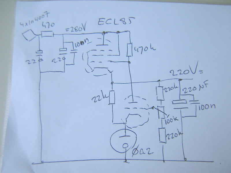

So these tubes could come in my next phono preamp ( now i use 12ax7's, with a ecl85-0a2 series regulator for each channel for that )
Hmmm....I'm always interested in seeing the schematic of that preamp if you have it...😉

at Audio Note England site (don't know exact url ) you can see few modifications for old Audio Inovations preamps ;
there you can find info regarding OA2 + something (5687 ?) in stab. circuit ; I'm pretty sure that I have somewhere these few pages,in case....
I still prefer pure shunt tube,without active element ,but-everyone have own cup of tea ........ 😉

You could also combine a series (pre)regulator with a shunt regulator, choke filter/reg plus a shunt, etc...
Markanica was however refering to a series reg using the ECL85 and OA2 which drew my attention as I once designed a very similar one but using the 85A2 or (better still) the 5651A as a voltage reference for a phono preamp.
I got it somewhere, but the scanner is out of order since it doesn't run with winXP and i haven't found an easy to use schematics drawing program yet....so no schematic at this moment.

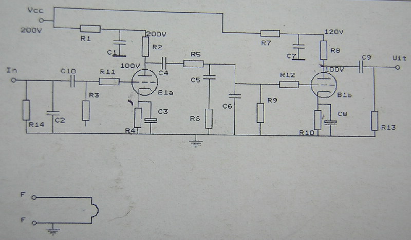

Phono & Reg schematics
Allright, I just used the camera as a scanner, works just as well 🙂
The phono preamp is from an Audio&Techniek magazine (Dutch) of the year 1994. It might be copyrighted so I left the values out. I hope that is ok.
The reg is based on a CROFT charisma preamp from around 1990, but slightly altered.
In my preamp the reg also feeds the linestage with ECC88 Mu follower.
Works ok on phono, but too much gain on line inputs.
All in all a lot of copying from my side, but hey I don't want to invent the wheel again... 🙄
