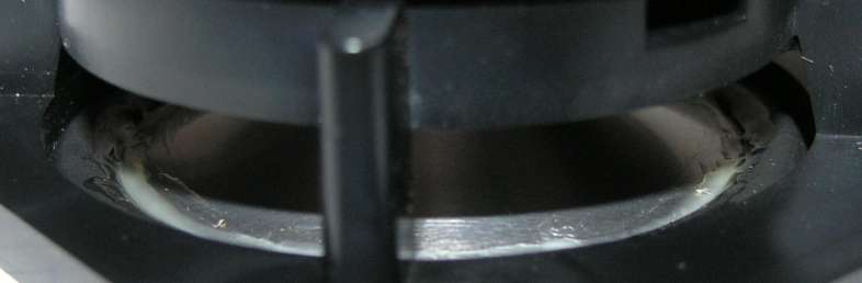

Some JXR6 unites appears to be badly glued - see appended picture.

Looks like you may have a faulty sample. Contact your distributor or Jordan direct and they should be willing to replace. It's not worth doing any measurement work with them until you have a proper set of drivers - any faults with the surround may cause all sorts of resonance problems. (If you have a matched pair, ask for both to be replaced whether or not the second unit shows the same problem.)
