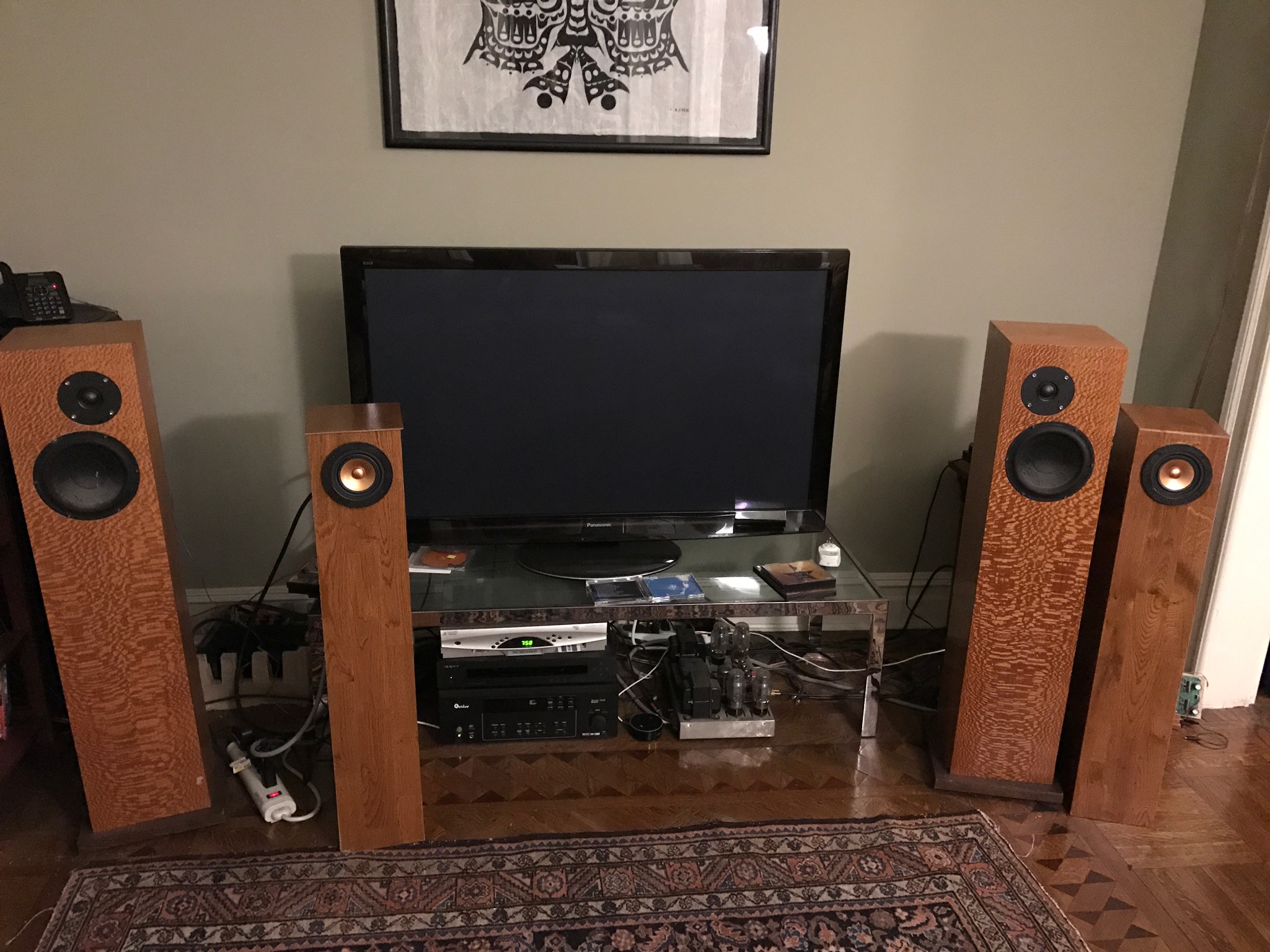

They are clones of the Response 2.5, then changed to use Scan Speak 9500 tweeter based on some advice I got from Troels Gravesen. Sound pretty good and go very deep, I measured them down to 25hz, but not a scientific measurement.
The Frugal Horns in "cinnamon oak", next to my Proac clones, in Australian lacewood. The TT and preamp are hidden behind the right speakers.
I brought the FHs up from the basement, and this time they sounded pretty good, better than last time. They do get some use in the basement so maybe they're breaking in. I had them powered by the "no longer a Dynaco" 6B4G PP amp, my Aikido preamp, and playing vinyl on my Rega Planar 3, with an Ortofon Quintet Blue MC cartridge. The MC preamp is peeking out from the right speakers on the floor (Boozhound). The hockey puck in the middle is my latest addition, an Amazon Echo Dot 2, "Alexa, turn on the tubes", and the tubes come on. "Alexa, play classic rock" and "Hotel California" starts playing. It's actually kinda creepy.
