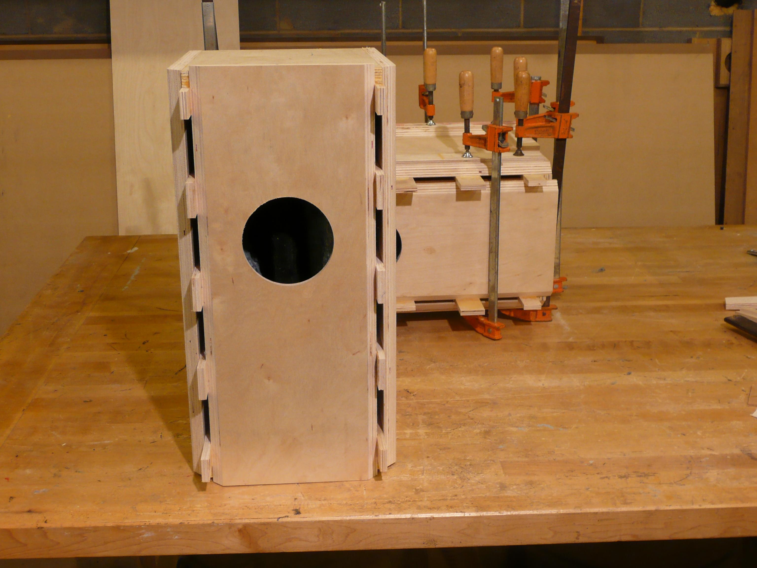

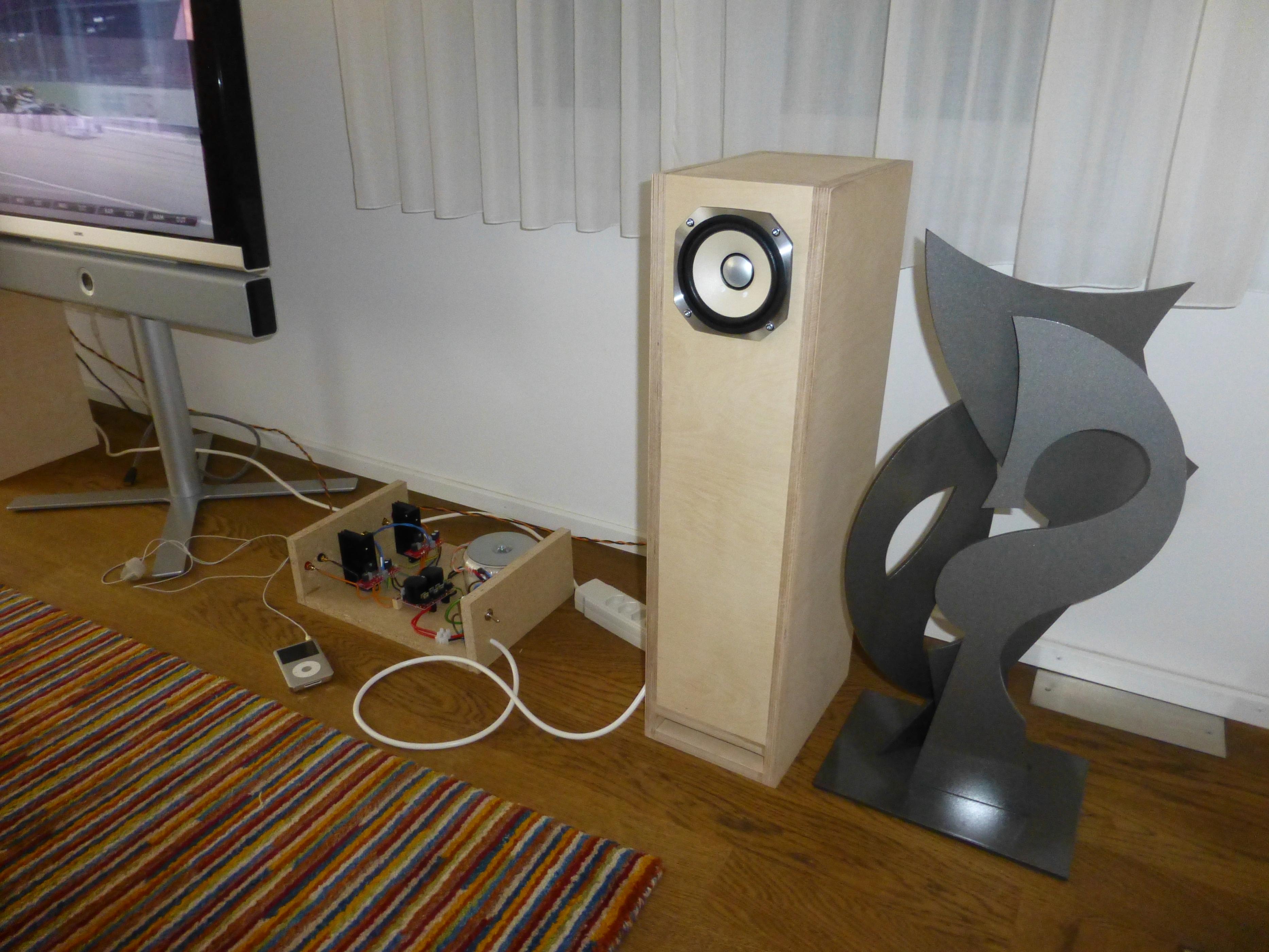

In case anyone is interested. I have just finished a double bass reflex box using a Fostex FX120 driver. The building plan and a picture is attached. There is a bit of damping in the smaller chamber and none in the larger. I did not use any correction network. So there is just plain wire between the amp and the driver. I used 16mm birch plywood for the box.
I broke them in using a 16Hz test tone for about a day. After that the sound was balanced. I have placed them fairly close to the wall. About 15cm.
Sound: Very subjective of course, but I think very clean, extremely detailed and very live like direct sound. Astonishing bass performance, but below 50Hz is missing. Voices sound just fantastic. Jazz music with them is awesome and very realistic. Miles sounds like he is performing in my living room. Classical music I did not try, but pop, rock etc. sound also great. They also can go loud.

How much bass are you expecting from 66.5cm2" ?????????????
But, congrats, it looks really nice.
How's the phase wrap in the male voice ?
Do you hear it ?
What are the 2 frequencies that it is tuned to ?
The double tuning seems to be a great tool to reduce excursion (always a plus!).
Maybe someday I'll try some fx120's, but not this year.

I do not hear any phase wrap in male voices. Louis Armstrong sounds natural and so does Buble, or Eagles, Tom Petty etc.
As for the tuning, the smaller chamber is tuned to 100Hz, the second and larger one to 60 Hz. (Also see the enclosure plan).
By the way, I was not complaining about lack of base. On the contrary. Bass is well defined, not boomy, dry and with enough umpf. you can pysically feel it. When sitting at the listening position everything is fine. What I meant was, they dont make the house shake 🙂

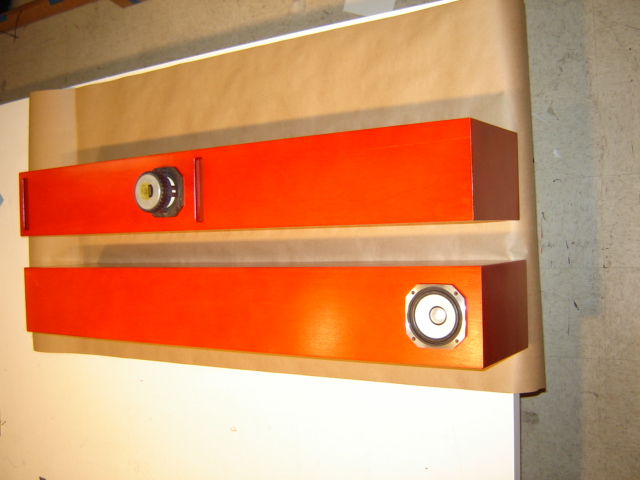

Certainly a robust sounding speaker, probably #1 in the bass department for that size driver.
I tried to make Double - DBR boxes, Ha! sounds like me, but it didn't work as well as hoped, the sound was just confusing 😕
(the bottom half makes a good stand, removed the drivers)

The cabinet design is the one that comes with the drivers. Free standing the bass is too lean. Placed fairly close, about 10-15cm, off the back wall the bass works well. Placement makes a huge difference.
Placeing them close to the wall also improves the WAF 🙂

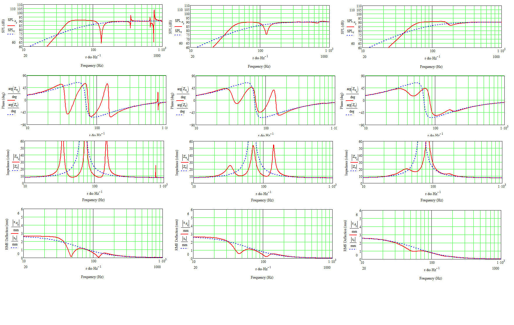

On the principle that I suspect somebody is going to ask at some point or other:
Left hand column: Fostex design sans damping.
Middle column: Fostex design with damping.
Right hand column: with electrodes attached to testicles, my prefered DBR alignment for the FX120 if a box of roughly similar size is required.
