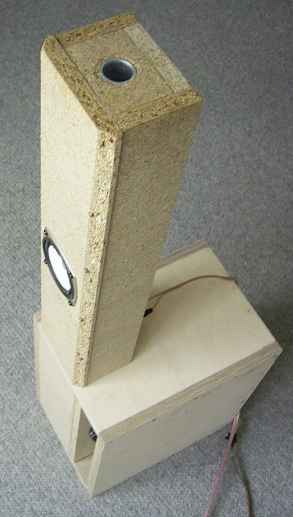

GM suggested a tower design, and I said, what the heck. I've got prototypes running with a subwoofer. See the thread about the XLS 10".
I haven't decided just how much I like the small towers. I think I hear a little bit of "shouty" stuff in female vocals that I don't hear with my Ariels. (Unfair comparison of course. The Ariels cost more to build than the small towers and subwoofer combined, and the Ariel box is elaborate.) I say I think I hear stuff. I have not done an A/B comparison yet. One audiophile friend is quite impressed with the little towers. Another is, perhaps out of politeness, less commital.

Cool, I used to have some FE103 based speakers in my office too (when I had and office... ).
They are quite good, but IMO the FF85 would be better for this particular application: ie, as a wide BW mid/tweeter. The FF series is a step up in clarity etc, based on my experience with the FF125.
BTW, AFA 'shout', the FE series responds very well to tweaks and cone doping. Send me an email if you want my 'secret' tweaks, or just search the 'fullrange forum' archives.

Hi navin,
since you are another strong supporter of the FF85k, Iwould like to present to you my latest configuration with this small jewel:
I combined the FF85k (in a small TQWT) with a dipole sub.
X-over is active analog 24 dB Linkwitz Riley (care of Behringer CX2310 http://www.behringer.com/CX2310/index.cfm?lang=ENG ) at 120-160 Hz. This is low enough to annihilate my dipole box resonance notch at 360 Hz and high enough to make the FF85k comfortable. Since X-over is active, I don´t care for the impedance peak @120 Hz.
The dipole sub (one for each channel because of the highish x-over, and because my equipment allowed for it anyway) is a Visaton W250 8 Ohm (http://www.visaton.de/english/artikel/art_645.htm) in a half W-frame. Sensitivity of both drivers matched perfectly, so I needn´t adjust levels at the CX 2310 in any way. Bi-amping is by vintage NAD 312 and NAD series 20 amps.
The dipole doesn´t go very low, but switching the 25 Hz low cut switch on the Behringer makes a hearable difference. The dipoles outer dimensions are 20x35x30 cm (WxHxD), keeping it in your WAF restrictions 🙂
In my 6 x 4,5 m room this combination is capable of quite impressive max. SPL (more than I would want for >1 min) and the FF85k is still safely in its Xmax margin. In the next weeks I will turn the FF85K back to Open Baffle (where it has been successfully before) to get a full dipole system again.
I am a VERY close-fisted guy and this is the cheapest system that could meet my "audiophile" demands. Since the Visaton W250 is a middle of the road standard woofer, you will certainly get an equivalent with comparable Qts, Fs, SPL and Xmax in India. So why not try something like that for yourself?

Has been quite late last night when I tried to explain my speaker configuration. I hope a picture will clear the fog ;-)From what I understand you have a dipole sub using 2 10" visaton woofers measuring 8"x14"x12" on top of which you have an FF85 in a TQWT?
The TQWT with the FF85K was developed with much appreciated help from GM (it was my first attempt at MLKs worksheets). The discussion was documented in some earlier thread in the fullrange-driver-forum. Maybe that is down the drain with the recent shift to a new forum format. But the plans are certainly still available from me, if anyone is interested.
The dipole bass started life as a true w-baffle according to SL. In favor of even less room interaction of the sub I splitted it in half. I plan to stack two of these "half" units and place the FF85K in a small OB on top of it.
The pictures show the actual system for one channel. Since it´s still under construction you need not elaborate on the craftmanship of the woodwork. I know how to do better! 🙂
You are right, Navin. In my configuration I have no means to boost bass electronically, so I prefer a Qts near 0.8 to get as low as possible. Qts~1.0 or even higher might be too sloppy. These drivers are far from hightech, but you will wonder what they can do in a dipole subframe.the Visaton W200 seems more suitable for dipole than the more expensive W200S.
