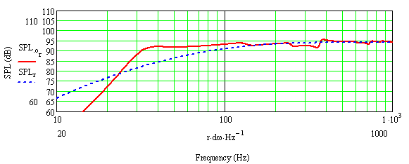

Hmm. In between latest formats & reinstalls of my PC at the moment (now on the 7th since New Year's day) so apologies if I'm only sporadically around for a while. Dead-easy solution though: using the above figures, and assuming that a horn of the more conventional sort is out for space considerations, I'd be inclined to do a nice & simple MLTL. Like this one (internal dimensions given)
54in x 9.25in x 12in (HxWxD).
Zdriver (distance of driver-centre from sealed end) = 19.875in
ZPort (distance of port-centre from sealed end) = 52in
Vent = 3in diameter x 1in long
Line the cabinet with 1in acoustic fiberglass on opposite faces (suggest top, back & one side-wall) or stuff 0.25lbs ft^3 from the top 30in down. I'd suggest 3 window-braces & a front-back brace that also clamps the rear of the driver securely to the rear panel. Birch ply prefered for the build material.
