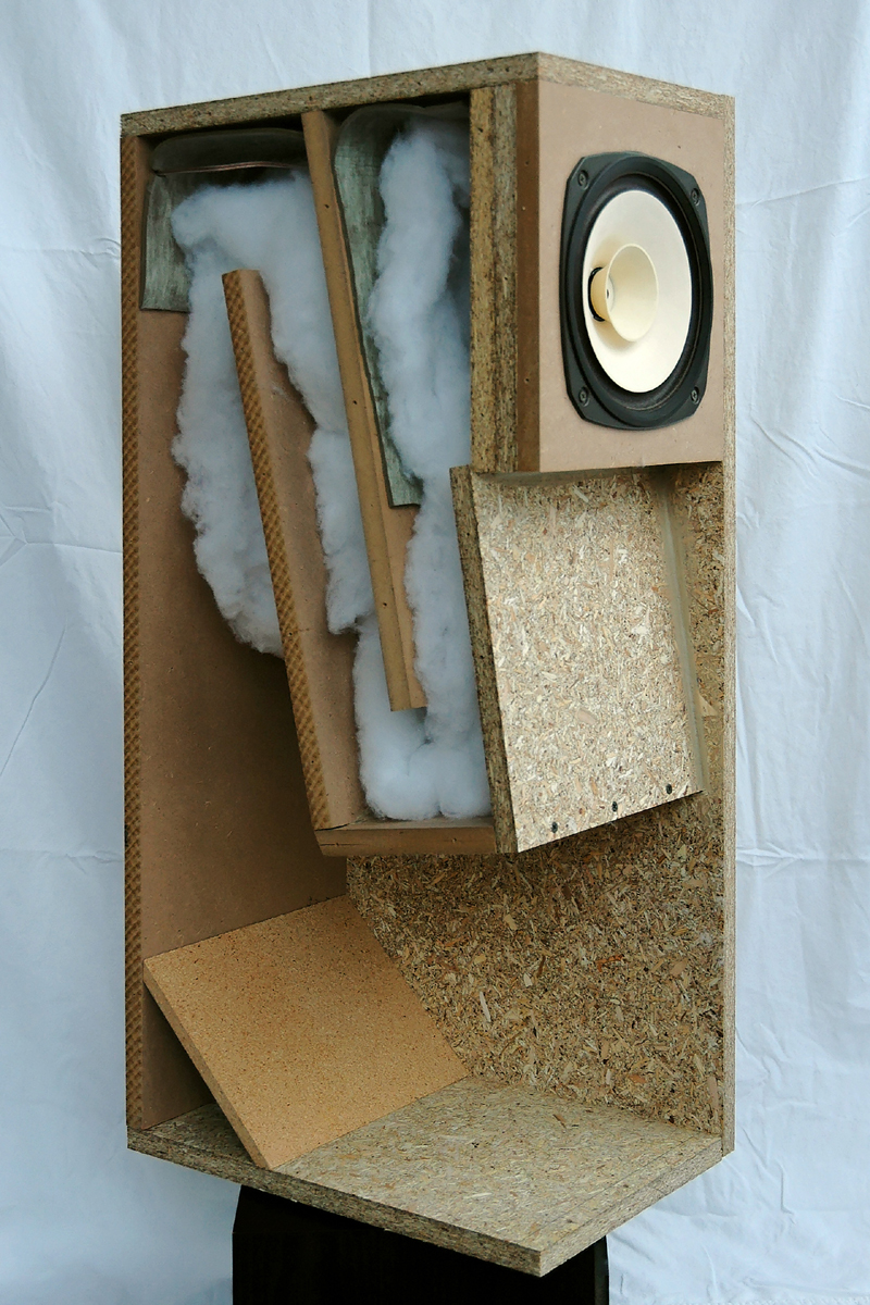

Two years ago, I bought a pair of Fostex FE207E drivers for testing.
My first enclosure was a rear-loaded horn (pictured) per Fostex design instructions. I also built a vented cabinet for listening.
Both enclosures sounded awful. The sound was dry, lifeless, and with absolutely no soundstage.
I have tried a variety of amplifiers: the Pass Zen v4, a hybrid Akikdo/MOSFET amplifier, tubed amplifiers (i.e. monoblock EL84), commercial amplifiers, and even the S-5 K-8LS.
None of these configurations have sounded good.
Any suggestions?

That looks like a BK-20 horn (not a Fostex Factory Design). Even when built as intended from plywood, and using the appropriate driver (one of the 3 8" fostex suitable for horn loading), it is not stellar. And stuffed as shown, it is likely a badly tuned aperiodic box.
I would also be leary of the Fostex recommended BR.
Add in the material you built these out of, and i'm not surprised with your take.
The 207 is not without its problems, but i would not call it awful -- even in a stock state. How many hours on them?
If you don't want to try for 3rd times a charm and put them in a proven box, it shouldn't be hard to sell them. The boxes should go into the tip thou.(sorry if that sounds a little hard)

Hi Kashmire, that cab looks like a Fostex BK-201 variant which is more oriented to the BLH-friendly drivers like the FE206E. I'm not sure that combo can be saved.
I see on your site that you also did BR and sealed, and were not happy. (Sealed will not go very low, obviously).

Hmmm ... surprising comments about the enclosure materials. It is a mixture of 3/4" resin particle board and MDF (the baffle, rear panel, and internal baffles are MDF). I wouldn't except the cabinet material in this case to be playing such a prominent role. In my opinion, there seems to be other obstacles to overcome before optimizing the cabinet materials.
I lost the build sheet for the horn cabinet a couple years ago. It was in metric, and it was a headache to translate all of the measurement to my english table saw. The prints were branded Fostex. The BK-201 looks awfully familiar. Maybe what I have is a simplified BK-201.
If that's the case, the FE207E isn't the best choice for horn loading.
However, I just haven't had much success with sealed or vented. I roughed up some boxes using particle board, MDF, and PVC pipe (for the vent) for testing.
It just does not add up........good drivers, good amps, and $5 a sheet cabinet material will always equal poor results.
I usually rough up a couple boxes using particle board and MDF for initial listening - stuff built from these materials should at least indicate promising performance. Many of my particle board creations have sounded excellent.
And stuffed as shown ...
Yea, I tried it stuffed and unstuffed.

Hi Kashmire, if you put the FE207E into a BR (or MLTL) with no circuit, it's not going to be balanced (i.e. it will be too forward, lacking bass unless the cabs are flush against the wall). The circuit compensates for the tendency of lower frequencies to "sneak around" the baffle, radiating in an omni pattern (thus dipping ~3-6 db depending on distance from the wall compared to the mids and highs which radiate all their energy forward due to the width of the baffle). Search for BSC or "baffle step compensation".
The FE207E will not have much bass in an undersized BR but in the right sized BR or MLTL, it can play down to and below its Fs of ~40Hz. But that circuit is key. Circuit is just a resistor and coil in parallel, optionally with a cap, which is placed in series with the + on the driver. It basically cuts above a certain frequency, but the cap eliminates the cut at very high frequencies (putting the sparkle back in).
It could be that you are missing the frequencies above 14k with this driver. The BSC gives you the opportunity to handle that as well -- cutting the midrange and then using the bypass cap of whatever value lets you effectively "boost" the treble in relation to the midrange. Still, a supertweeter is a better solution if you need to play up to 20k.

However, in interest of maintaining an adventuresome spirit, I'm going the give the 207 another chance by implementing the step filter. If that doesn't help, I'll toss the horn/vented/sealed enclosures altogether and try it open-baffle with my dipole woofers.

You have to deal with baffle step in some fashion. There are lots of clever ways aside from a circuit:
1. At the design stage, deliberately (!) put a "hump" in the low frequency to coincide with baffle step.
2. Put a passive circuit between pre and power amp.
3. Digital EQ
4. Use really wide baffles.
5. Use a driver that has a hump in the response around baffle step (one manufacturer recently designed this into a driver)
6. Circuit of course. The bypass cap is optional and based on your taste. It just defeats the amount of cut provided by the coil and resistor.
Any of these would work for sealed and vented (any design, really) to some degree. The circuit is the classic choice if the box is already built. Without some kind of baffle step strategy, your speaker's bass will be 3-6 db down unless flush against a boundary or two (or three).
