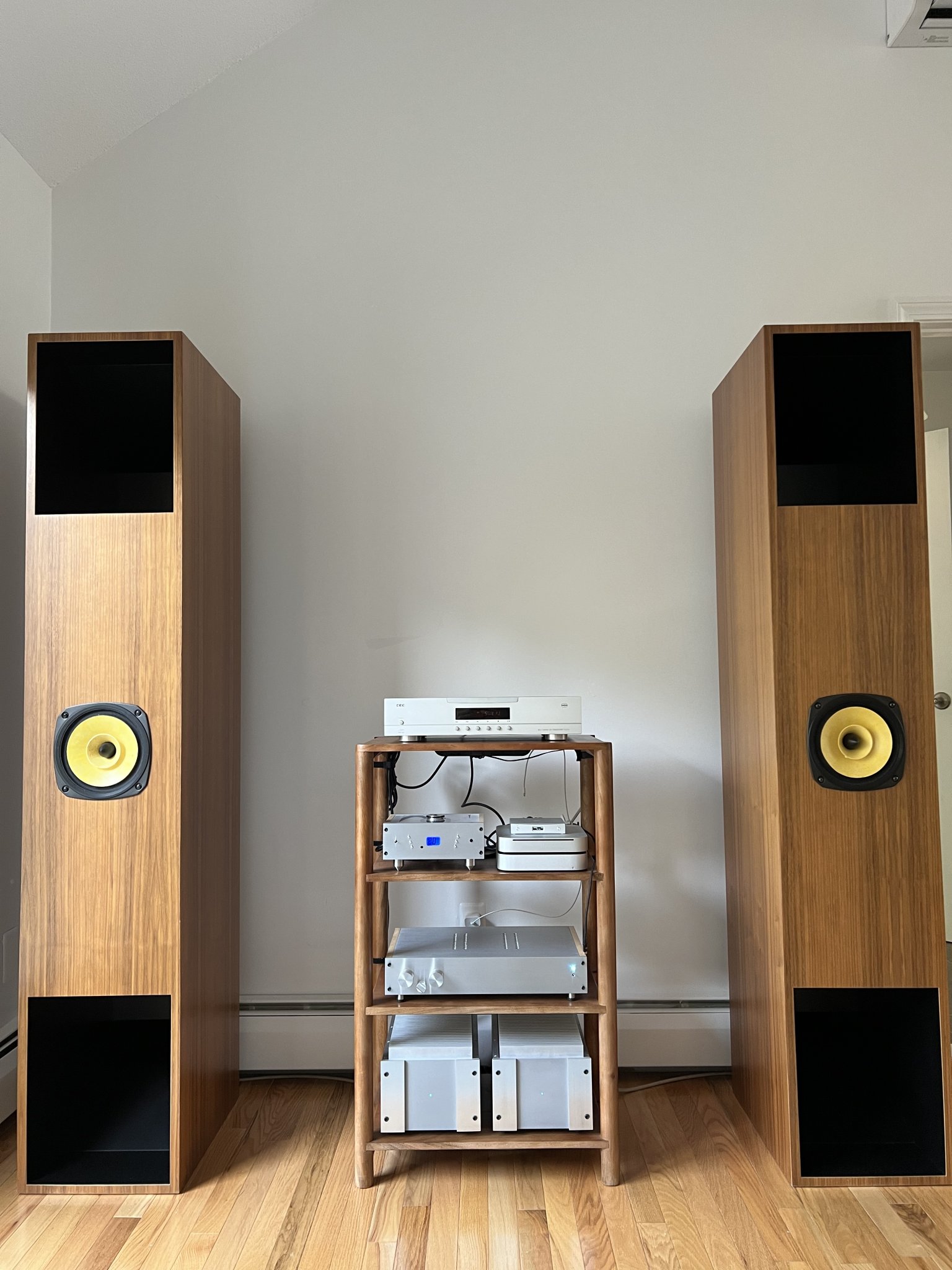

Fostex FE206NV project is finished.
Some ML-TL derived from a Martin King project for Lowther that with some modifications fit into the TS parameters of the Fostex, these being very similar to those of the Lowther Dx2.
http://www.quarter-wave.com/Project04/Project04.html
To equalize this extended range I decided on two notch filters centered at 2.6k and 9k and a step speaker that starts at 150 hrz.
It has a rise of about 5 dB above 10k, very suitable for those of us who have lost sensitivity in those highs.
The impedance was very friendly for the tube amplifier with which this system will be used.
Note: Hornresp was used for the design and simulation of the box. Jeff Bagby's spreadsheet and XSim were used to design and simulate the filters. For response measurements the REW and for impedance the LIMP. All software free to use. It was measured with a Dayton IMM6 calibrated microphone.

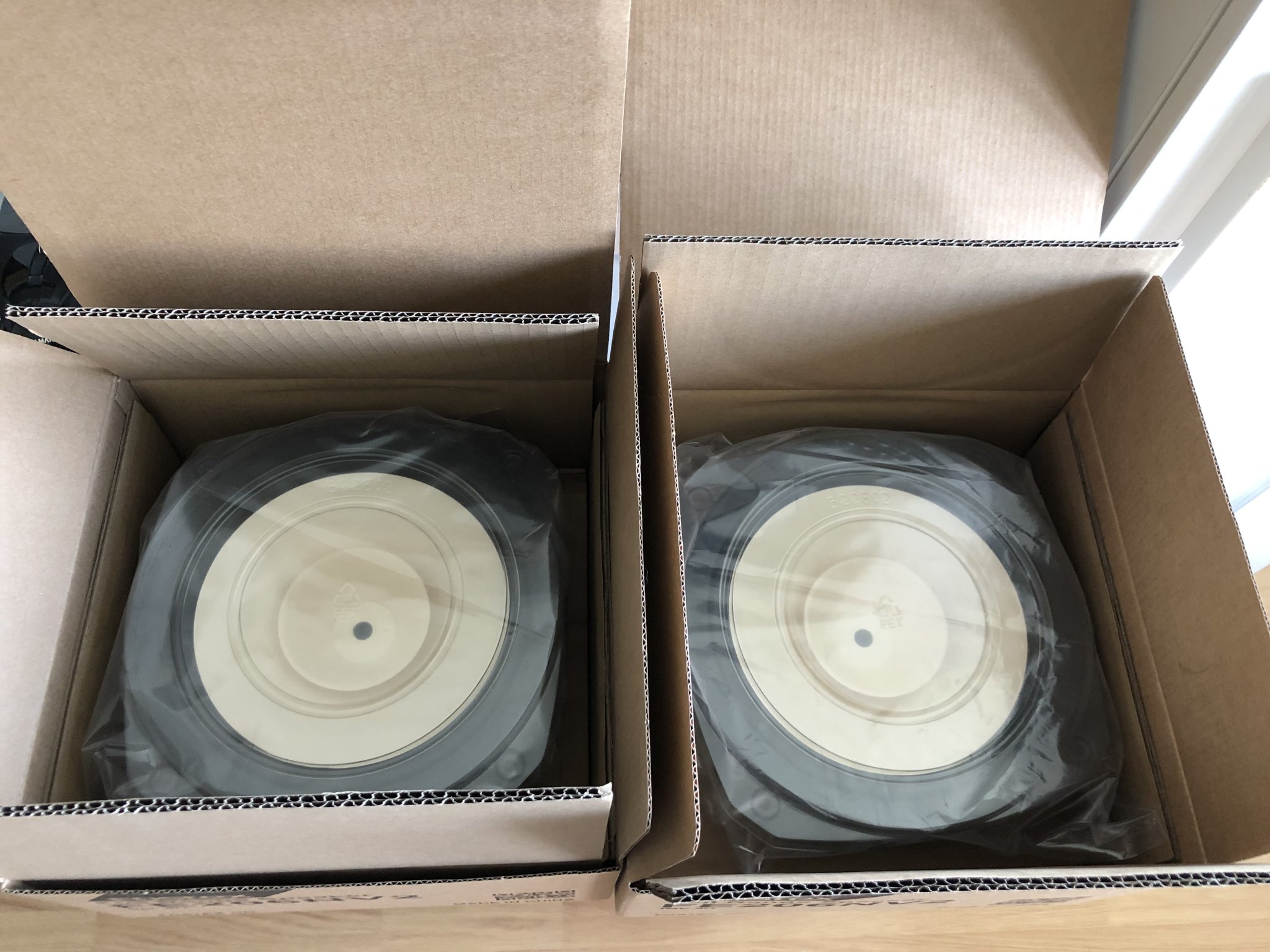

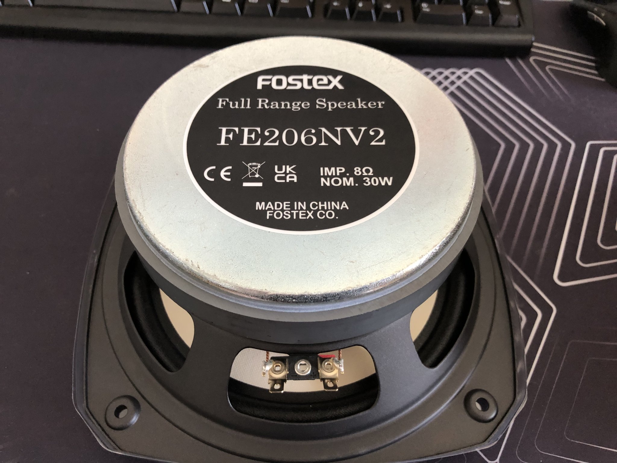

I also have 2 FE206NV2 sitting in their boxes and would like to build some good enclosure for them - preferably double front loaded horn like Sachiko or Kirishima.
I wonder if somebody will re-make Sachiko / Kirishima drawings for newer Fostex FE206NV2 line - these cabinets were not updated for a very long time and eN drivers are anyway obsolete by now?
