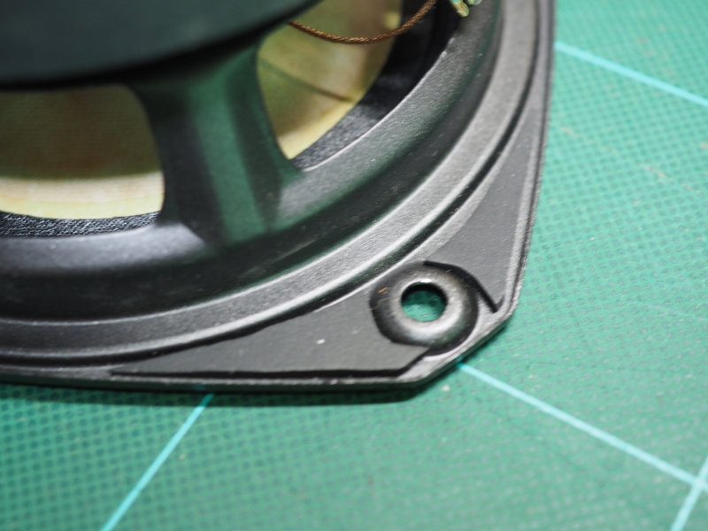

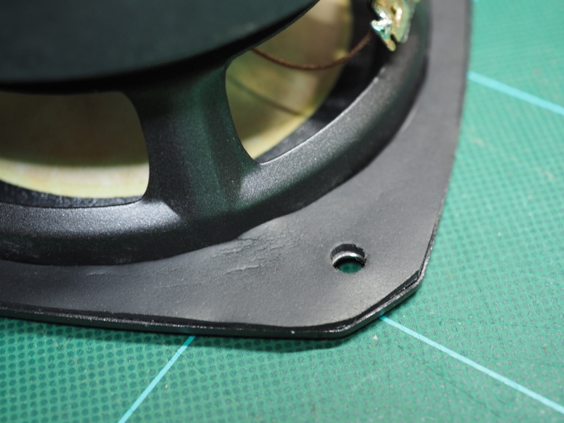

Good evening everyone. I thought I would share pictures between the two Fostex Fe EN vs the Fe NV driver’s. I have not heard the new Fostex FE126NV drivers next to the FE126EN drivers which are one of my favorites. So I will be doing a project with the New NV drivers soon. So here is my take on each driver Just looking at them both side by side.
Fostex FE126EN Driver’s.
1. Has a bigger magnet.
2. The cone is almost very light and almost see through.
3. Heavier.
4. Nice live sounding.
5. You get more Info on the drivers Mechanical specs and small parameters.
6. Has been around a while.
Fostex FE126NV driver’s.
1. Cleaner wire hiding and no white dots on the cone from soldering.
2. The magnet is not so big and is more rounded even.
3. Gold plated terminal’s and are spaced out a little more from each other.
4. Frame is more of a glossy black and not a coated black finish.
5. The cone looks cleaner around the edges and the middle dust cap.
6. The cone looks more stiffer and has sparkling on the cone? Fairly dust 😀
7. Shipping with a plastic speaker cone protector.
Things I don’t care for in each driver.
1.Still has a steal frame and can cause a problem if you don’t dampen it some how.
2. Magnet is either to big or small nothing In the middle or a different type of magnet material.
3. NV has very little info on published driver Info like T.S.
4.FE has a sloppy look to around the dust cap and outer edge of the cloth sound.
5. Charges a lot for the drivers.
This is all I can think of. Again I will be working on a project soon with the new drivers and I will post pictures and give my honest opinion. Cheers Jeff
There's a full data sheet here: https://www.fostexinternational.com/docs/speaker_components/pdf/FE126NV.pdf
