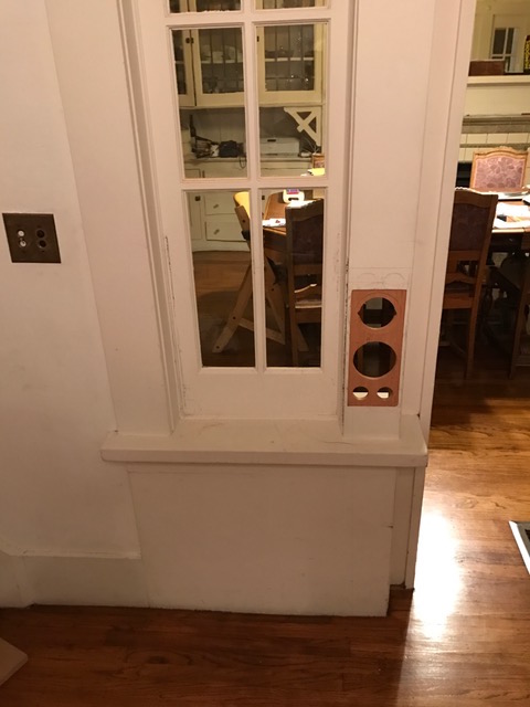

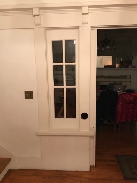

First hole cut in the pillar! I opted to keep it in place, rather than replace it and have to redecorate.
http://www.diyaudio.com/forums/attachment.php?attachmentid=599296&stc=1&d=1487098525

Choice between removing the baffle, cutting a hole and mounting a recessed baffle behind, or just routing out the baffle in place. Chose the latter. A little messy, but will clean up just fine.
http://www.diyaudio.com/forums/attachment.php?attachmentid=599298&stc=1&d=1487098525

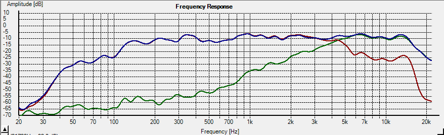

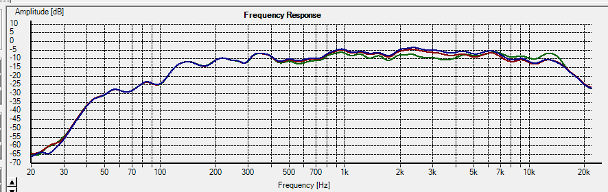

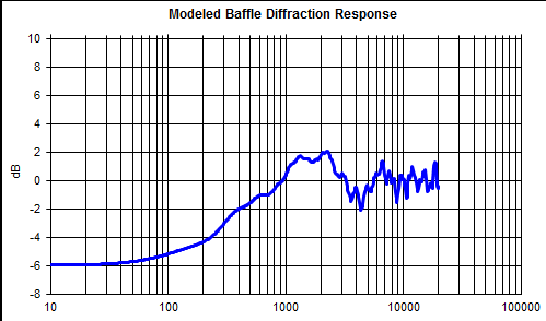

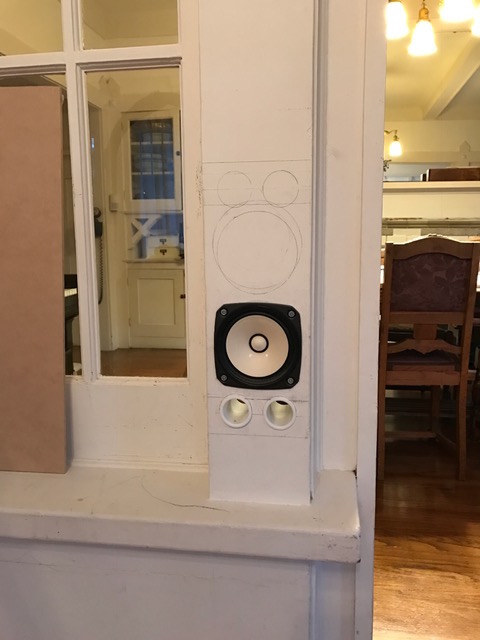

Made great progress today. Managed to finish my routing, get the tweeter in, do hours of listening and tweaking and then design a passive crossover to match my active crossover settings.
Response Modeler suggested I'd have a hump of +2db between 1 and 2k and this was exactly what I saw.

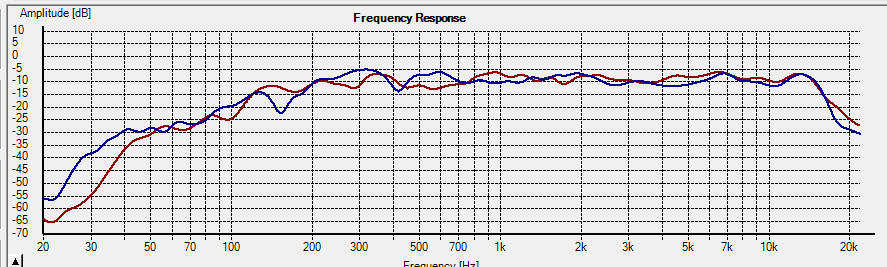

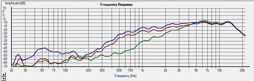

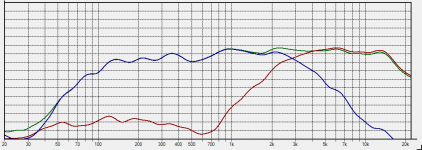

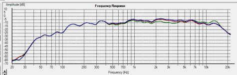

This was my measured result with the active crossover (what I'm aiming for). This is with a -2db equalization applied at 1k - 2k. It may seem like it should have more, but this sounded about right. Note that I crossed it higher than I originally intended - now about 2.8k. The nice thing about the active crossover is it allows for a lot of experimentation.
Note the dip at 500hz. Adding EQ didn't sound right and I know these kind of measurements aren't necessarily reliable in the room, so left it as is.

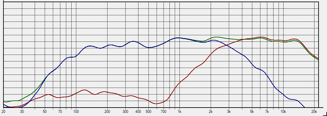

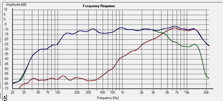

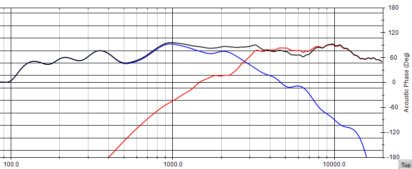

This is the graph I got from WinPCD crossover designer. I used the measured Woofer FRD, modeled ZMA (exported from Response Modeler) and the factory tweeter FRD and ZMA files. It's about as close as I'll come for now. I can tweak it later.
http://www.diyaudio.com/forums/attachment.php?attachmentid=600373&stc=1&d=1487571702

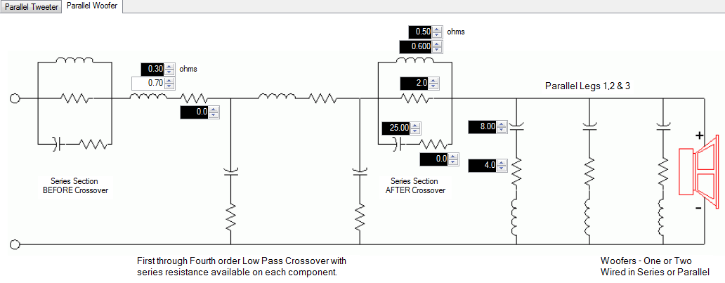

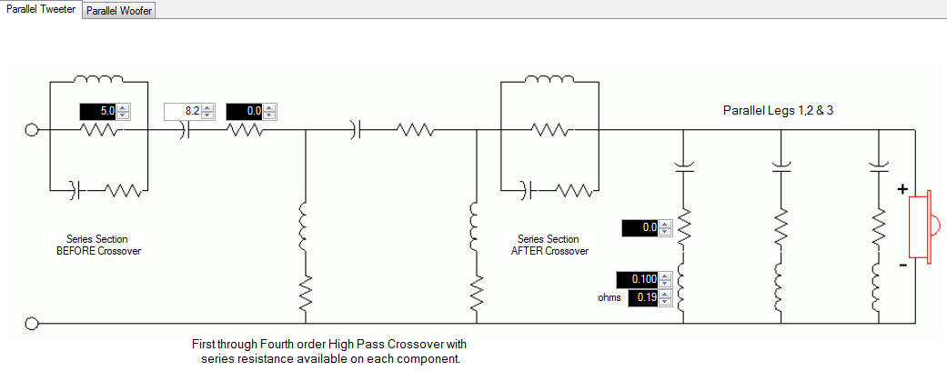

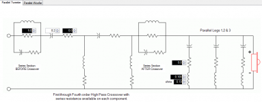

Here's the schematics:
http://www.diyaudio.com/forums/attachment.php?attachmentid=600374&stc=1&d=1487571802
http://www.diyaudio.com/forums/attachment.php?attachmentid=600375&stc=1&d=1487571802
I used an RLC notch filter for the 1k hump and a zobel network for steeper roll-off. Also the 5ohm resister in the tweeter circuit was just to get the factory FRD values to match up with the measured one for the woofer. I won't actually use that.

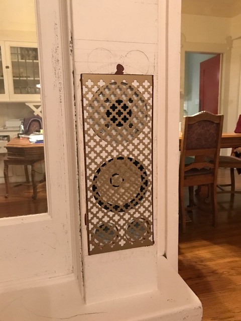

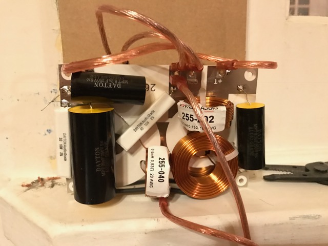

Well... massive development today!
Passive crossover components arrived yesterday expedited from Parts Express and I managed to find time this evening to put it together and measure it.
http://www.diyaudio.com/forums/attachment.php?attachmentid=601172&stc=1&d=1487918642
To say I'm pleased with the result would be an understatement. It wasn't *quite* what I was intending in terms of the crossover point which is now actually around 4k. But I seem to have fluked it somehow because the overall curve measures pretty flat. The notch filter is working perfectly at keeping it relatively flat around 1 - 2khz. It looks like it might have a slight hump around 7k (somewhat ironic given it's a characteristic of the Fostex I was trying to eliminate), but it's not noticeable.
http://www.diyaudio.com/forums/attachment.php?attachmentid=601174&stc=1&d=1487918642
Still needs painting, but here is the current state of the woodwork and grille
http://www.diyaudio.com/forums/attachment.php?attachmentid=601173&stc=1&d=1487918642
Cool!
Careful of putting inductors close together. They can act like transformers and do all sorts of interesting things.
Chris
Chris
Had some time to tweak this evening.
Started by trying a lower crossover point by substituting the 0.7mH / 8uF combo for a 1.5mH / 15uF combo with a 1ohm resister on the parallel tweeter inductor.
The result produced a pretty flat response and a crossover point at 2.8khz, but I didn't like the sound of it as much. I felt like the openness of the Fostex was stifled a little.
So I decided to leave the woofer as is and play with the tweeter setup a little. My baseline was my original design of 0.7mH / 8uF which for reference is here:
http://www.diyaudio.com/forums/attachment.php?attachmentid=601314&stc=1&d=1487997860
I then tried 3 different tweeter settings shown here. Blue is 15uF with the 1ohm resistor on the parallel inductor. Red is the 8uF with the 1 ohm resistor. Green is 8uF without the resistor.
http://www.diyaudio.com/forums/attachment.php?attachmentid=601313&stc=1&d=1487997860
This gave me the following 3 curves:
http://www.diyaudio.com/forums/attachment.php?attachmentid=601312&stc=1&d=1487997860
The latter baseline is the flattest overall and even has a little boost up in the 10k+ range, which is good because that gets a little damped with the grille in place.
What's was really interesting was to compare the baseline to the LS2a/2 that's being resigned to storage. Blue is the Rogers. Red is what I've made. Pretty close I'd say.
http://www.diyaudio.com/forums/attachment.php?attachmentid=601311&stc=1&d=1487997860
Cool!
Chris
Yea good warning Chris. I was careful to put them at different 3D planes to each other. It would probably be optimal to have them a little further apart, but I'm no expert. I suspect the crosstalk is minimal if the fields they're producing are on different planes.
Found this, which would suggest that it might be better to have them a little further apart despite the orientation: http://www.troelsgravesen.dk/coils.htm
