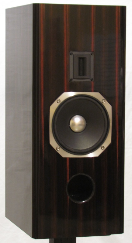

That is some beautiful veneer. Also, the bellmouth vents made of wood look really nice. I can't believe you have not stuffed the drivers in for a listen yet! 🙂 I have heard some very nice things about the FE126 in a Frugelhorn Mk3 (FH3) - lots of threads on it - do a search and you will find it. But if you want to try this driver in a nice horn, that would be a good place to start.

I do like the cabinets, I have put beeswax on them and been polishing like mad, which is after the picture was taken. I will post once its all in situ.

3) nice work on the veneering

The Macassar Ebony is lovely.... and expensive. We did a pair of uFonken clad in it.

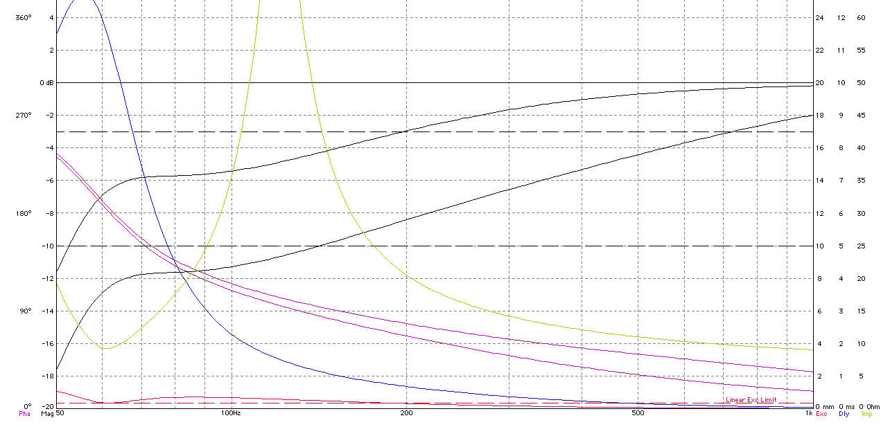

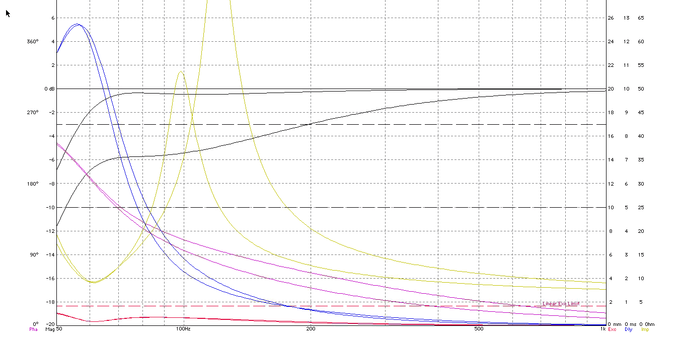

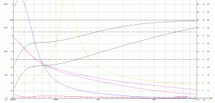

What i do hope is that this project does not turn you off full range, as this particular box design conspires to exagerate what the FE126En does not do all that well. Warning: after spending all that money on those boxes what follows may be painful ... but there is an out.
From the sims you can see that with this box any bass response you have will be way down which will exaggerate the FE126's forward midrange and the 7k peak.
attachment.php
The top curve is half-space (ie what you would get if you mounted them flush in a wall or approximately what you would get with BSC added). The lower curve is with no filters and a simulated 6 dB of baffle loss. You would need a 2-stage filter to give any semblance of flat response. You would lose some 12 dB of sensitivity and then you run into the very low xMax which means that for anything but nearfield use you are likely exceeding it, and even there you probably won't be able to really push them. Further, in our experience, this kind of filter reduces the speakers DDR (downward dynamic range) and wipes out some of those things that makes the FE126 special.
All of these things work together to make this enclosure what another member described as a cruel joke.
Not all is lost thou. The FF125wk will drop right in and give much more satisfactory results (top curve). The box is still a bit big, and perhaps could be tuned a bit higher, but they could be done after the fact. Just add up to 2 litres of solid fill. Make it irregular, stick it to the backs, sides, level with the driver to break up standing waves, and on the bottom/top.
attachment.php
dave

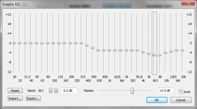

Plug a computer into the amplifier, and use Foobar2000 or even iTunes.
Using the equaliser, apply the curve shown below.
The overall HF shelf is -3dB, for baffle-step compensation.
Then overlaid there's a broad notch filter around 7kHz. These drivers have a lot of output around the upper midrange, and this should knock them down into line. Should sound more "relaxed".
Put something reasonably neutral on (try Sultans of Swing, for example), and listen right through the track. That should give your ears a little time to adjust to what you're hearing.
Now play anything you like.
Tweak the eq if you want a more forward/detailed sound by reducing the cut around 7kHz.
If it sounds too warm and lacking in definition, move all the attenuated sliders up by a decibel.
Make incremental changes. What I've shown will be somewhere near, but your tastes will be different to mine.
Chris

So I threw together a really quick Linkwitz Transform (using the positively astounding iTunes eq), which brought the bass back in line.
At a couple of metres listening distance, there's still considerable volume available. Not as loud as it was before, for a couple of reasons:
1 - I've run out of gain before the soundcard clips
2 - I can see the surround of one of the drivers deforming slightly when any low end comes along, so won't push it much further.
Still sounds rather good, though. Its also a sound that I'd call full-range: nothing's really missing.
If you block the port with something reasonably solid and check the cabinet volume in WinISD for an idea of where the rolloff is, you could do something similar very easily.
