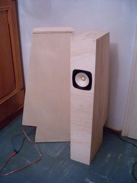

126 vs 127
I have been trying to make a choice between 126 and 127 and came up with 127. For me it is more suitable for a TL design and high frequency response looks to be more balanced. The result is a well balanced sound and good low end extension. The upper bass response gives the sound a strong feel. You can not go very loud with these drives (disco levels) but they full fill a room of 35 meters square.
Onur
