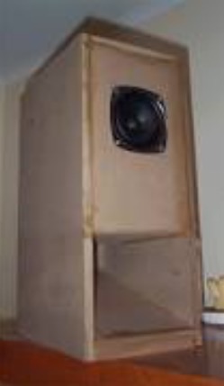

We did build the Fostex recommended horn. In the end we burned it. We weren't happy with it.
Frugel-Horn Mk3
dave
Frugel-Horn Mk3
dave
