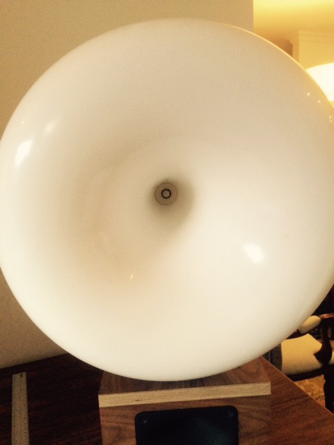

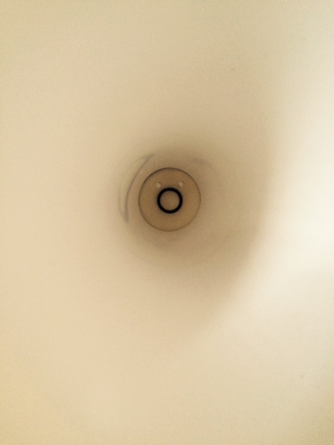

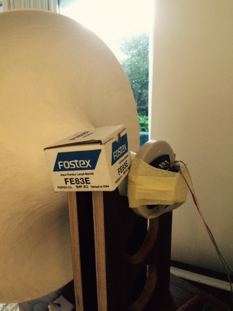

I recently tried Fostex 83 in my large Azura 340 horns. The sound was clean and easy, though laid back. A lot less detailed than a standard compression driver. Andrew

According to Hornresp, a compression chamber effects the front wave high freq extension greatly (not reflected sound, but loading of the driver). Maybe that is why it sounded so "laid back"?

At the moment, I'm using Faital Pro HF200, which works very well. I can run it veryow from 500hz if needed, but presently 800hz xover. No separate tweeter at this stage. Getting towards 17,000hz.

Off topic, sorry, but: nice plywood radial horns you've got there in the background!
Would you care to share some details? (Design, hypex or exponential, cut-off freq., etc.)
Did you have them made? Is it a bespoke thing, or are they normally available for sale?
Thanks!
Marco
They are CNC machined by Artluthe Audio in Montreal. I bought them rough cut, and had to do the sanding and finishing. Great fun project. They sound very smooth. Vocals are very natural, but percussion isn't as real as the metal horns. They are 800hz bi radials xover at 1khz.
