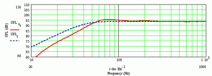

Internal dimensions: 38in tall, 9in wide, 12in deep. Stuff the whole cabinet with a density of 0.5lbs ft^3 of Dacron or similar. Centre of the driver wants to be 8in down from the internal top. You can either rout a slot near the base of the cabinet (wherever makes you happy) & damp it to taste, or use two of those Scan Speak Aperiodic vents (I'd suggest the rear of the cabinet) which will make it fractionally under-damped, and adjust the density of the internal stuffing behind them. The latter look nicer, but they cost about $8 apiece, while routing a slot in the cabinet is free. Response is attached. As you can see, it doesn't go especially low. Should sound pretty decent though, with a suitably 'fat' bass. You can flatten it by cramming more stuffing into, or behind, the vent
