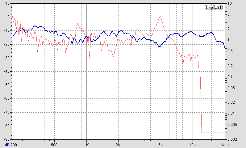

I have bought a few days ago some F120A drivers at a bargain price (126€ each, instead of 250 !).
I mounted them on an Open baffle of approx. 40cm*35cm with 10cm deep walls.
And I could do the measurements I could never find on the Internet. 😀
My setup is actually quite poor :
- Nvidia 24bit/96kHz motherboard-integrated soundcard (high noise, poor THD)
- DIY microphone with preamp (see my website for details)
- no SPL calibration
- measurements made in a 14m² room, with no particular treatment. Maybe the weakest point of the setup...
So, let's roll and begin with the frequency response at 1m !

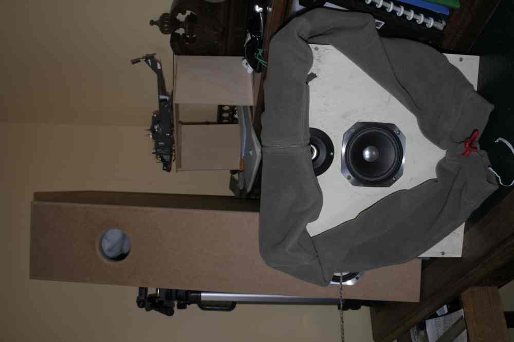

now, let's talk about sonics :
I installed the dampened open baffles in front of my usual speakers to see what they are worth.
Dampening is made of clothes, polar wool and floor-cleaning stuff (as you can see 😀 )
BTW the cheapo tweeter above the F120A is not used : it is just there because I didn't want to build another OB to measure it 😀

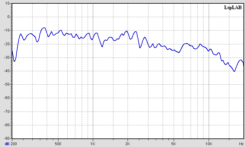

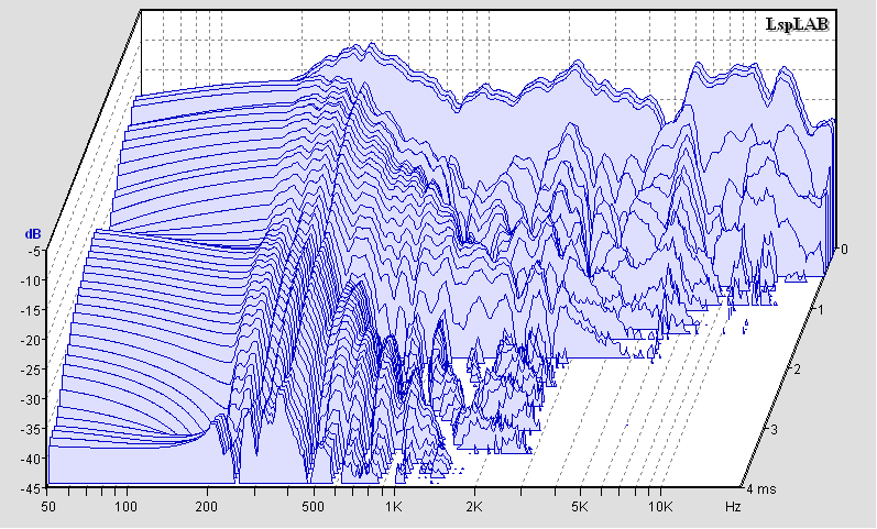

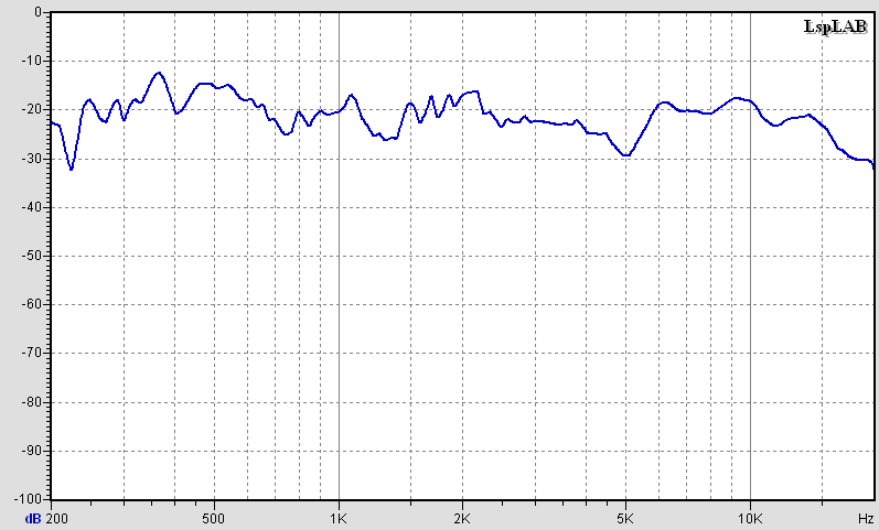

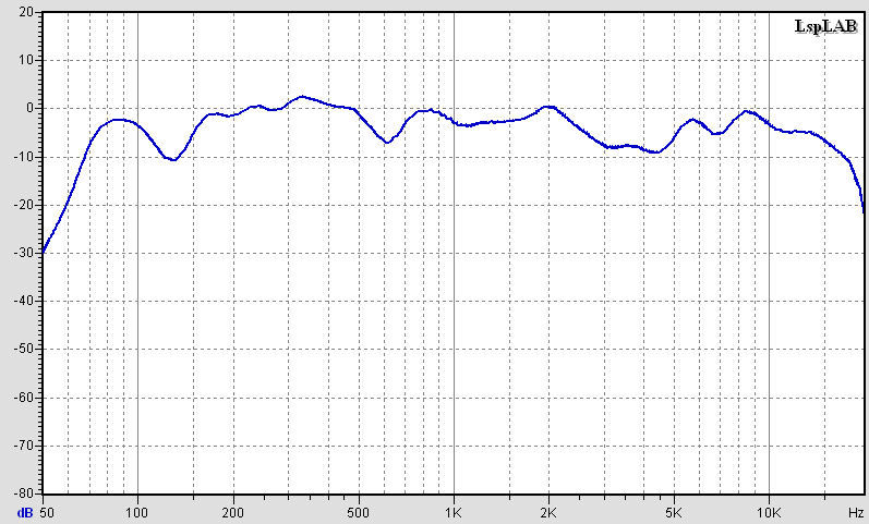

A bit of equalisation is needed to compensate for the baffle step and little room interference. (shown is the unequalized response)
I must say I have been surprised to see that Open baffles seem to be less prone to peaks & dips in the bass frequency response than normal speakers. I've been pleased to verify this point that I was a bit sceptical about !
