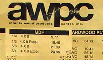

Kofi,
The easiest solution is to just pick up some 5/8" thick mdf. I happen to know a great place that carries it in Atlanta, called Atlanta Wood Products:
http://www.hardwoodweb.com/company/awpc.cfm
I would call ahead to see if they have it in stock if you are able to go there, as it is quite a far distance for you to travel.
When you get in there, they have a price list that you should pick up to see what is going on. I attached a screenshot of the mdf pricing part of the price list from the last time I went there. They also carry about 4 grades of mdf. I bought the top grade last time for my speakers, and it is much better than the home depot stuff. It was called PanFiberExcelPlus, and was $26.88 for a 4'x8' sheet of 3/4" mdf. I am not sure of the grades they have for 5/8"
Good luck with your project. I would just use the 5/8" mdf and you should almost be able to fully follow the plan with some unit conversions and sanity checks.
BTW: I finally bought a house last week, and it is about 4 miles from this place, and I move in on July 15th. Thanks for the advice.
Brian

OK.... OK.... Kofi's feeling better now. I called AWP and they have 5/8" MDF. I'll be running by there tomorrow to get some.
With the 103E design, I'll be out .875mm for each board if I use 5/8", but I'm thinking that won't amount to much in the end. I should be able, as you have described, fully follow the plan. If I compromise on the dimensions of the internal spaces, I'm thinking I'll be out about a millimeter or so per gap. That's not the end of the world, right?
Also, I should still be able to use my 3/4" MDF for the external portion of the cabinet. This would seriously cut down on the amount of wasted wood product.
