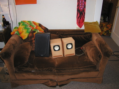

photos.
this is the small system I made and sold to a friend.

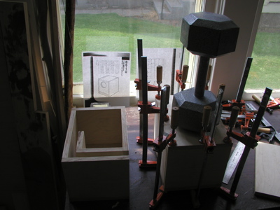

too much scrap plywood, need to buiid...
