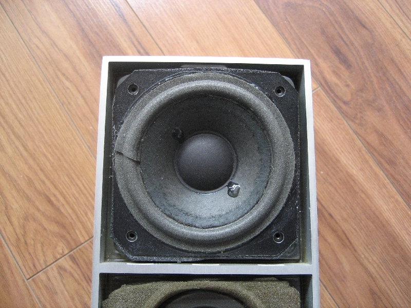

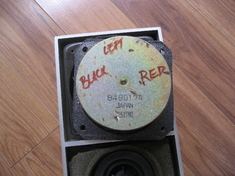

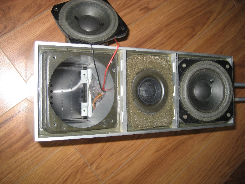

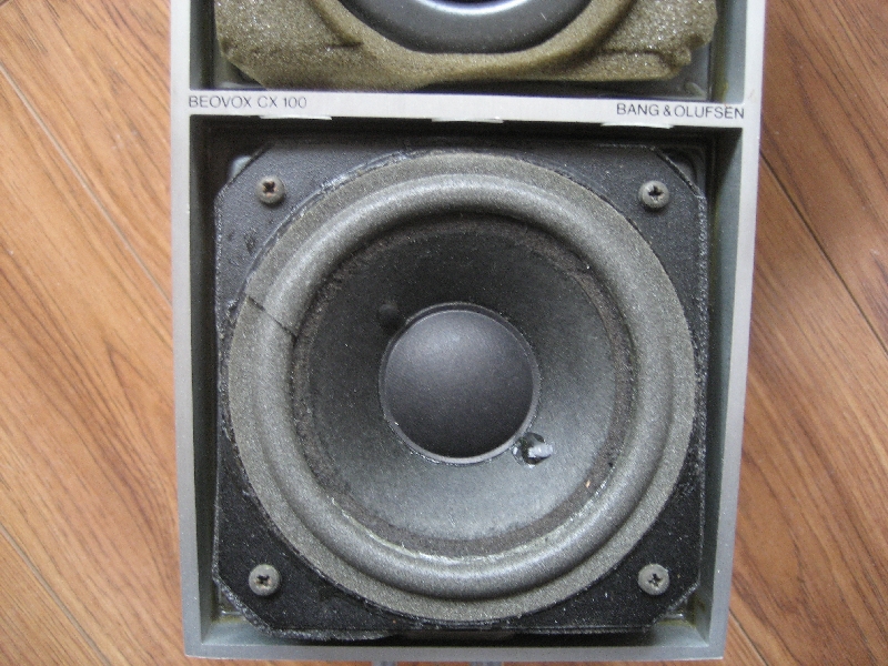

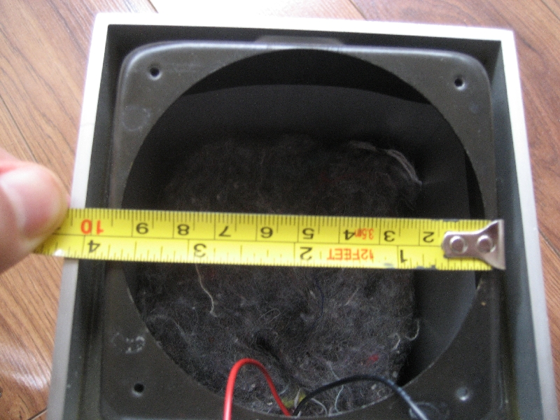

Hello Dave,
Here are the pictures as requested.
add info:
- width (between screws) is 11cm
- opening hole is 9cm
add info:
