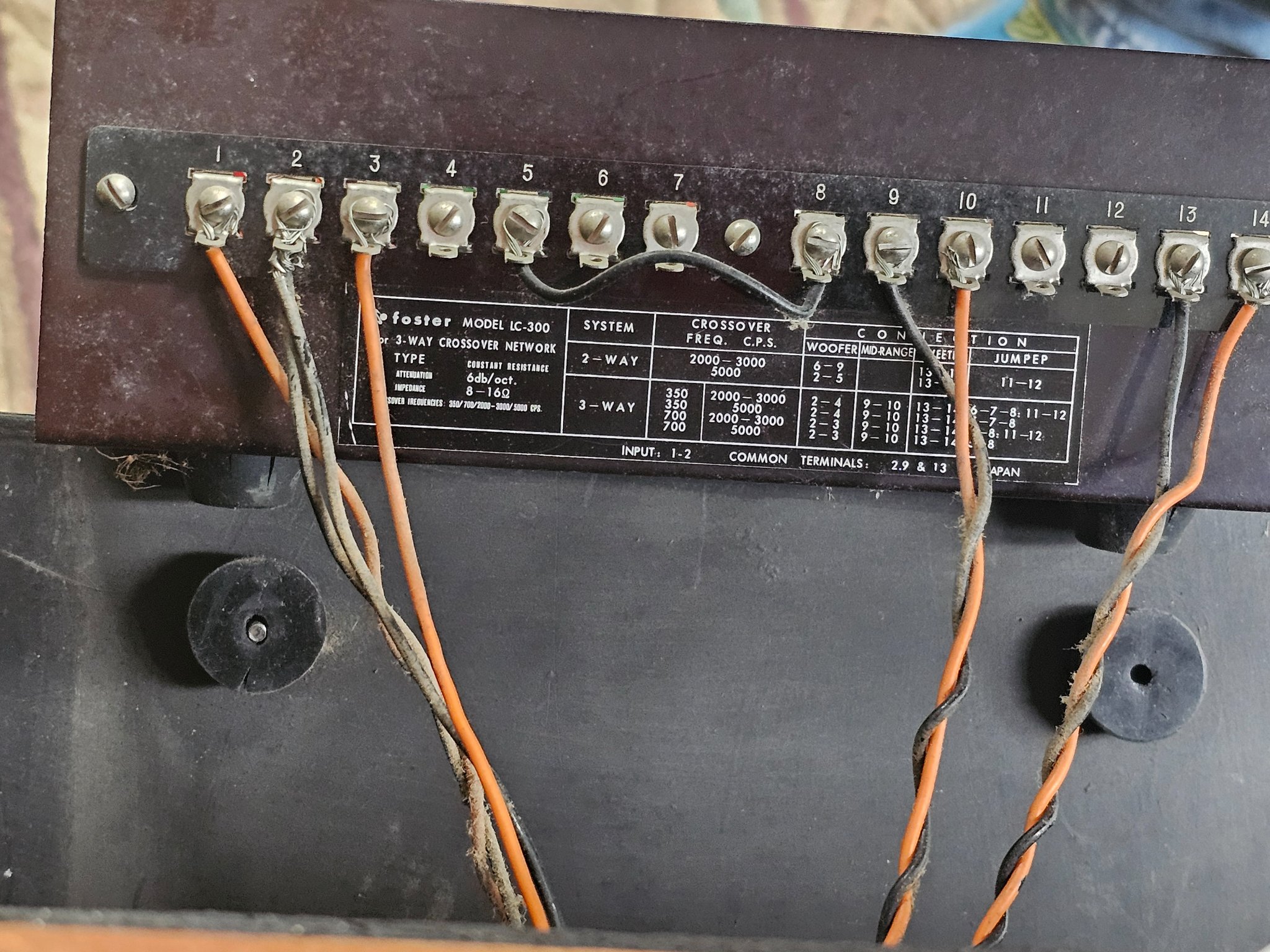

Would a photo help? - I've opened up the crossover and can see the components reasonably clearly.
I didn't actually realize that it was 'enclosed'.

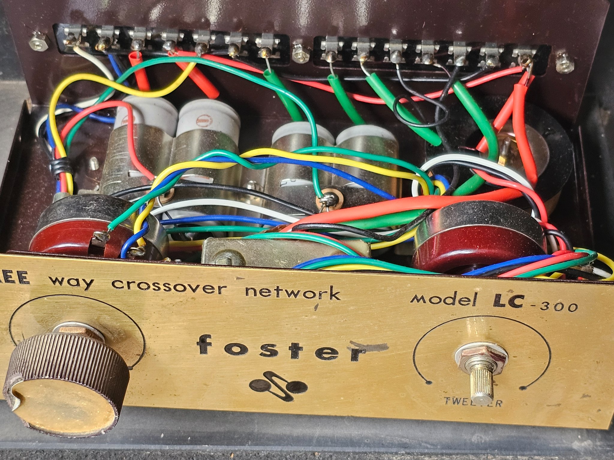

A photo of both the component side AND the underside could probably help me and many others to advise you further.
Even posting some values you can read might help 🙂

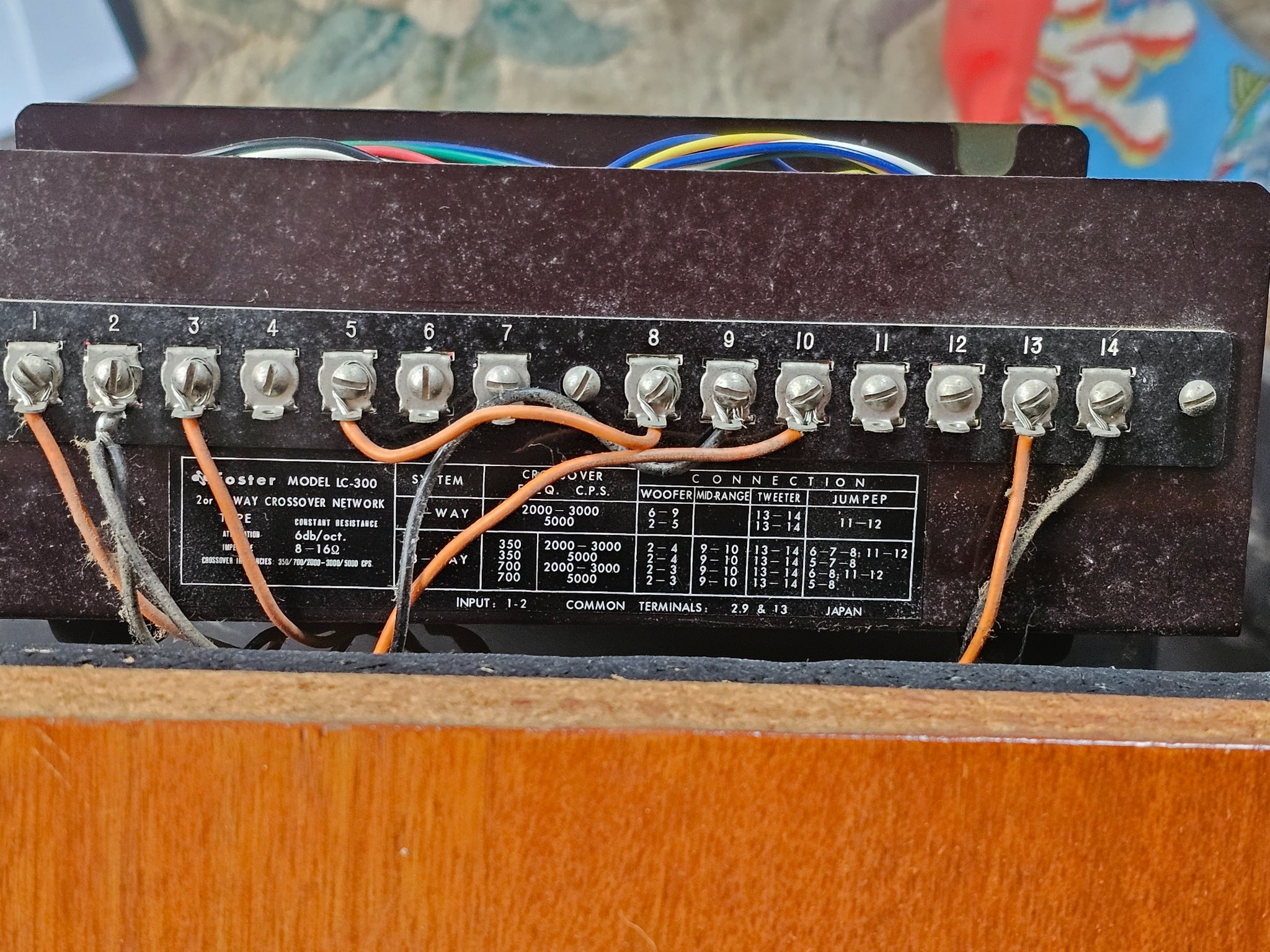

Here are pictures of the Foster LC300. I think i can put the power amplifier output directly into the terminal board. (?? Nos. 1 and 2??)
I wasn't able to remove the capacitors to get values, because my socket wouldn't get into the space available. The two (i suspect they're wire wound) pots are 8 ohms each. I think they might be unnecessary unless they affect the roll off characteristics.
I see 😕
That looks like a very old unit. There are certainly lots of connectors (and wires) - not quite what I expected.
I see quite a lot of labeling on the rear > does this not explain some information?
The 'wire wound pots' you see would actually be something called L-pads and are used as volume controls for the midrange and tweeter.
I am 99% sure this is a three way crossover. The labeling of the L-pads as 8 ohms indicates this unit is meant for 8 ohm speakers.
This might be relevant & helpful, but I'm not sure (?)
https://www.google.com/search?q=foster+l300+manual+pdf&sca_esv=b3743c3edb8cdec9&sxsrf=AHTn8zoWgv-czB0FbiNENRUHqS46_DM8dQ:1745549122082&source=hp&ei=QvcKaPH3Apmjvr0PtZHboQY&iflsig=ACkRmUkAAAAAaAsFUko2zBlIEBPq8qiFt2RDfNYP72BA&oq=foster+L300+manual&gs_lp=Egdnd3Mtd2l6GgIYAiISZm9zdGVyIEwzMDAgbWFudWFsKgIIADIFECEYoAFIuOoBUABY89QBcAB4AJABAJgBlQKgAbcgqgEGMC4xMi44uAEByAEA-AEBmAIToAKmIcICBBAjGCfCAhYQLhiABBixAxjRAxhDGIMBGMcBGIoFwgIIEAAYgAQYiwPCAgUQABiABMICCxAuGIAEGLEDGIMBwgIOEC4YgAQYsQMY0QMYxwHCAhcQLhiABBixAxiDARjHARiKBRiOBRivAcICCxAAGIAEGJECGIoFwgIIEAAYgAQYsQPCAh0QLhiABBixAxiDARimAxjHARioAxiLAxiOBRivAcICCxAAGIAEGLEDGIsDwgIUEC4YgAQYsQMYgwEYqAMYiwMYnQPCAg4QLhiABBjHARiOBRivAcICBRAuGIAEwgIOEC4YgAQYsQMYxwEYrwHCAhEQLhiABBixAxjRAxiDARjHAcICFxAuGIAEGKYDGMcBGKgDGIsDGI4FGK8BwgILEC4YgAQYxwEYrwHCAhcQLhiABBixAxiDARikAxioAxiKBRiLA8ICFBAuGIAEGKYDGMcBGKgDGIsDGK8BwgIGEAAYFhgewgILEAAYgAQYhgMYigXCAggQABiABBiiBMICBRAAGO8FwgICECbCAgYQABgHGB7CAgQQABgewgIGEAAYCBgewgIIEAAYBxgIGB7CAggQABiiBBiJBcICBBAhGBXCAgcQIRigARgKmAMAkgcGMC40LjE1oAehpQGyBwYwLjQuMTW4B6Yh&sclient=gws-wiz
PS.
If you only have one unit, what project were you thinking of?
If it is actually a stereo crossover then the L-pads would be for tweeter volume only.
