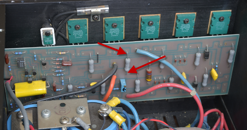

I've read a few posts here about adjusting the Bias and I'm a bit confused on which resistors are the emitter resistors. I've attached a pic of the board. Can someone point out which is the emitter resistors and which posts I should get the meter readings from when adjusting?
See attached image. Ultimately, an arrow to the component would be helpful 🙂
Also, there is talk about replacing the pot for a 20 turn and this board has one I believe. Can someone send me a link to the correct POT to purchase? I've got a Forte Model 3 and a Forte Model 1 that I'm getting up and running.

The right leg of the big transistors are the emitters and connected to each emitter is a big gray resistor, that's the emitter resistor. Put one DMM lead on one end and the other lead on the other end. Use mini-grabbers or clips if you have them. The left leg is the base and the middle leg is the collector.

Yes measure where the two arrows are pointing.
Just measure across the one resistor. The other resistors are assumed to be the same.
This was very helpful. The Forte Model 1 is running now around 48 degrees Celsius. Sounds FANTASTIC!
Please note, the emitter resistors varied in millamps around 68mV to 75mV when at 48 Celsius. Is that a concern that there is a wide range?
If so, what should I be looking at to see if there is another component I should determine if it is failing. Or is that just the +/- of the component tolerances?
