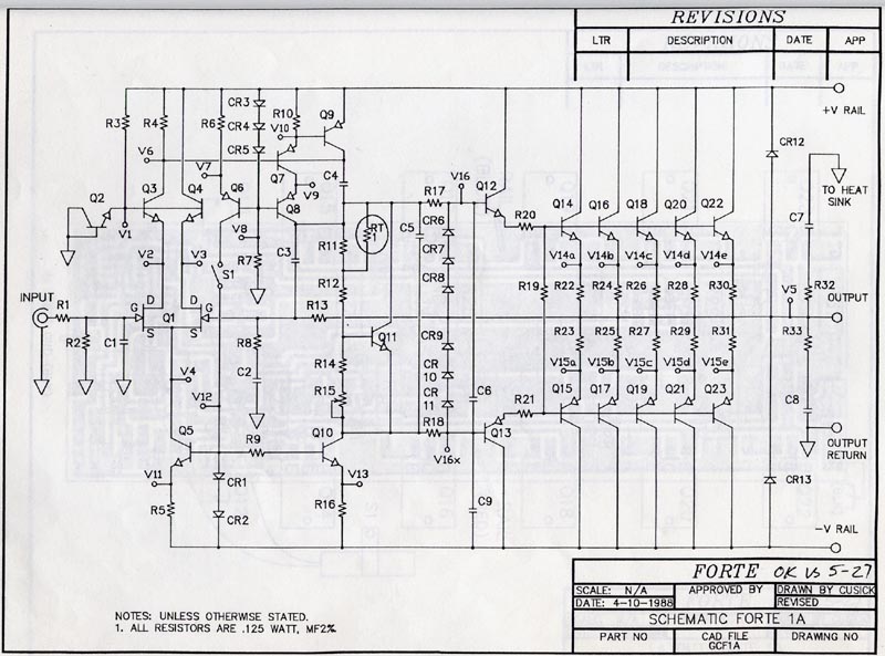

is there a big difference between Forte Modell1 and Model1A ?
Or they are similar ? A schematic would be very helpful.

The primary difference was a JFET input stage on the 1A,
replacing bipolar devices.
I don't seem to have a schematic, but the circuit was ordinary
enough - N channel JFET diff pair followed by a PNP common
emitter voltage gain stage, both of these constant current
sourced. Vbe multiplier for the bias, and complementary
emitter followers for output stage biased into Class A. Very
simple.

Hello Mr. Pass
thanks for your fast answer. I will get a Modell1 next week, my first NP amp. Perhabs do you remeber which tranis used in output-stage and how much is voltage usually for rails, so i can look for electrolytic caps

how much is bias set
hello
my Forte1 come in an it runs nice. On headsinks I read low temperature about 40 degrees Celcius. Across the emitter resistors ( 3,6 Ohm ??) my meter shows 460mV. Works this amp in right condition? What is right value for bias ?

Re: how much is bias set
I think you can safely crank it up to about 45 deg C. Do it
carefully, and monitor the current for an hour or so.

Has anyone turned up a schematic for the Model 1 or 1A?
Used Model 1's are coming onto the market and I want to be prepared.
It seems there's an upgrade article for the 1A in
audioXpress May 2003
* "A MOSFET Update of the Forte 1A Amplifier, Pt 1"
which I probably have somewhere. But I'm thinking of purchasing a Model One since the price is right.

If you were the new father of a Model 1, what would you do to it?
The Audio Amateur article (thanks Walter) is almost a complete replacement reusing the power supply and chassis. It's basically a new amp when you're done. (I do have some unpopulated A75 PCB's laying around, perhaps an A75-lite?)
Is there something less drastic you could do, other than replacing the now old electrolytics caps?
(Have soldering skills, not design skills, yet)
Still haven't found a service manual for this yet. The guy I may get getting this from doesn't have the manual or know where to get one.
Probably not interested in turning it into an Aleph. At 30-watts or so its too little power to be a main amp and too much to be a bi-amp tweeter amp.... although... could be an excuse to make the next speakers hi efficiency horns.

I had 3 fortè audio 1a, and I think i'll have in pdf format instructions, list of components used and the schematic.
Nelson may have some tips but it appears to be a completely direct coupled design.Other than checking for proper bias levels and DC offset issues,the filter caps and maybe bridge rectifiers might be all you need to be concerned with due to their age.Did anyone ever find a schematic for the 1A? I'm considering giving my amp a refreshing once through and a schematic would make that easier.
