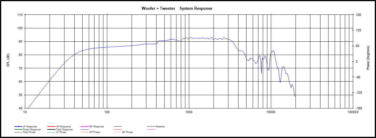

Hmm. Might work. Based on the current data it's a fairly easy driver to work with, but with diffraction, step-loss you're likely to be down in the LF with it run wide open, so system tweaking via level padding on the HF leg may be tricky. For e.g., here's a very quick / rough model, 14in x 8in HxW baffle, 3/4in roundover / chamfer applied, vented enclosure 16 litres tuned to 40Hz; box response hard-spliced in at 300Hz & a nominal voltage source amplifier. I've stuffed it into PCD just for the purposes of displaying the response. Might work, but you'd need it up against a front wall, or preferably placed on a suitable shelf with sufficient hard-packing around it to effectively bring the baffle flush to avoid the drop off < ~570Hz or so.

That plot is one of the reasons I want to play with the driver. While certainly different in many ways, the breakup looks reminiscent of the a26re4 but with better extension in a smaller, in this case ported box.

Not dissimilar in the sense it has a relatively smooth HF rolloff -at least for the initial octave. Quite impressive for an alloy cone designed for a limited operating BW. With my multiway designer hat on though, leaving aside step-loss, diffraction etc., you might be able to run it sans filters like a Seas A26 or the units it (the Seas) recreates, but I'd be a little concerned about the potential for breakup induced HD to become audible in the passband -without an HD plot with level (hope Yevgeney gets some) we don't know for sure. OK, that's arguably not what was meant above -assuming 'it is what is published' you've the option of hyper-simple or more complicated if desired & you want to get the most performance out of it.
Sans that data, then in multiway-designer 'critique' mode, there appears to be a touch of energy storage at about 425Hz (which may be a measurement artefact) & a little at about 2.6KHz, give or take. From the general curve shape, it's well behaved, though I might keep an eye out for a bit of inductance modulation. The fact that I'm writing that at all for a driver advertised at less than $50 says a fair amount though, since you normally would be in 'expectation management mode' for a 6in driver at this price point.
