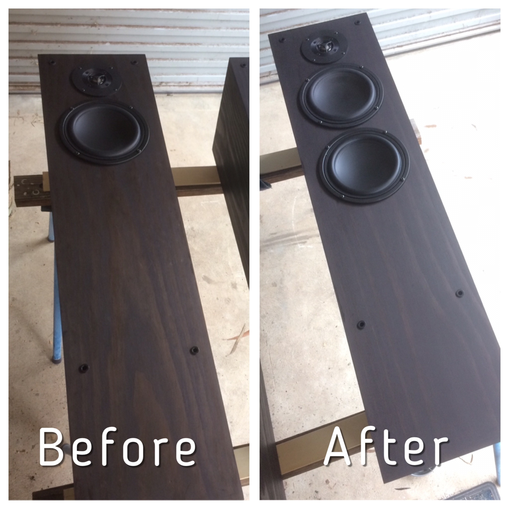

Also, I've finally completed these by stealing some pre-made grilles from some old dicksmith (DSE) tower speakers, shown above with silver drivers, and nerve-rackingly drilling holes and installing cups to mount them. Photo isn't too great but they came up looking a treat! Almost can't tell they were DIY now 🙂

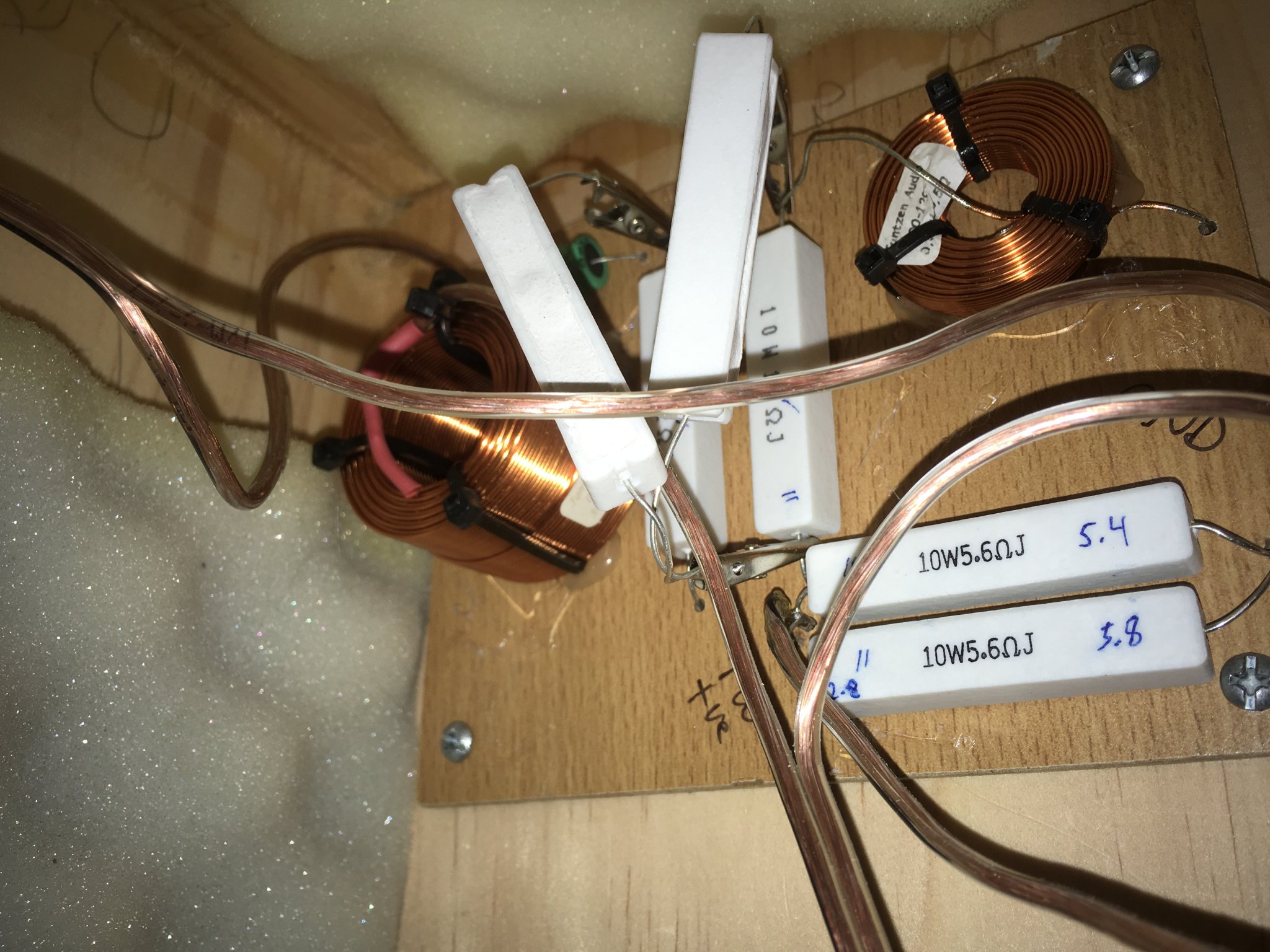

The l-pad looks weird because I actually had these speakers working with a different tweeter for quite some time after originally failing to get the Jaycar tweeters working how I wanted. Unfortunately the other tweeter went EOL so to be able to quickly and easily change between tweeters I made it so I could alligator clip resistors on the l-pad in parallel to get the desired result without re-soldering the crossover. Makes for quick changeover.

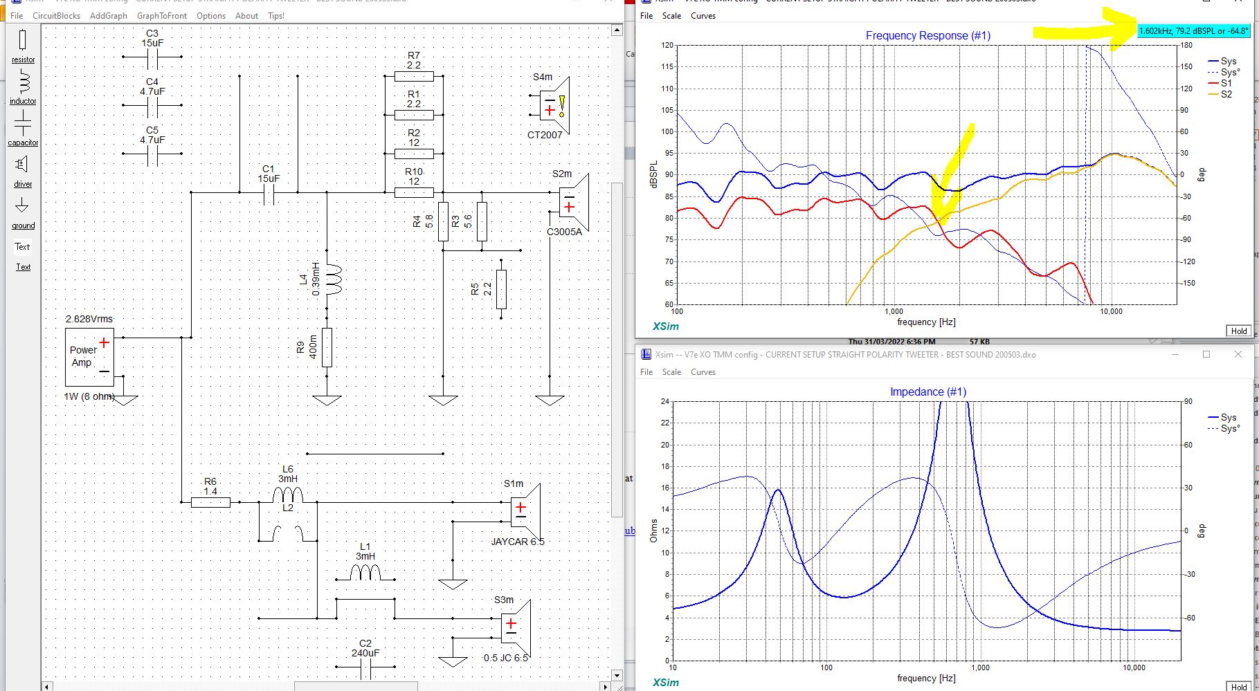

The main issue, DATA! Specifically, lack of it! I love Jaycar but garbage in = garbage out. Without proper info (and without proper measurements) I couldn't theoretically design something well enough that could then be fine tuned (at least by me). I plotted responses from picture graphs to actual data files where I could but it was still not great.

To fix the bass (my idea for BSC) I moved to a TMM design and chucked in an extra woofer, running in parallel with the original.
Shorter bass port gave stronger bass response with 40mm length (in my room / environment at least) with removal of port entirely (just the 19mm thick wood hole) making them sound like a subwoofer in P-plater car days (beefy at a particular note but not great across a range).
Have a look at xsim snapshot, I messed around with components quite a bit to be honest, I don't know if this theoretical response graph is even close to what I'm actually getting but at least they sound the best they ever have while I've been using them!

(yes, those resistors are connected with alligator clips, I was 'seasoning to taste' and heck of a lot easier than soldering each time haha)

I'd like to build a speaker one day using the CT2007, to make a point I guess. I'd probably print a waveguide for it. I'd choose a woofer to suit it and make good use of EQ. With the right cabinet and crossing there's no reason it shouldn't sound good.
There are a few things I'd suggest about your sim but first, Xsim doesn't show phase separately unless you set it that way. Until then at least you won't have any need to see the blue phase trace you see now, just red and yellow.
