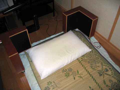

for pillow-side
This system is for pillow-side.
I use Fostex FE83 with repulsion magnet.
Cabinet is back loaded horn and horn length is about 2 meters.
The sound is like a headphone's one. It's interesting.
I couldn't imagine the sound at all before listening.
The distance is very short ,so bass range doesn't decline.
