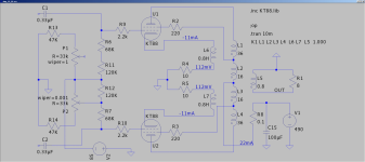

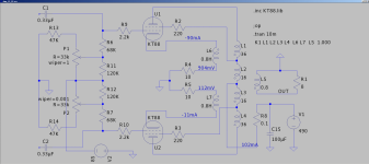

Hi !

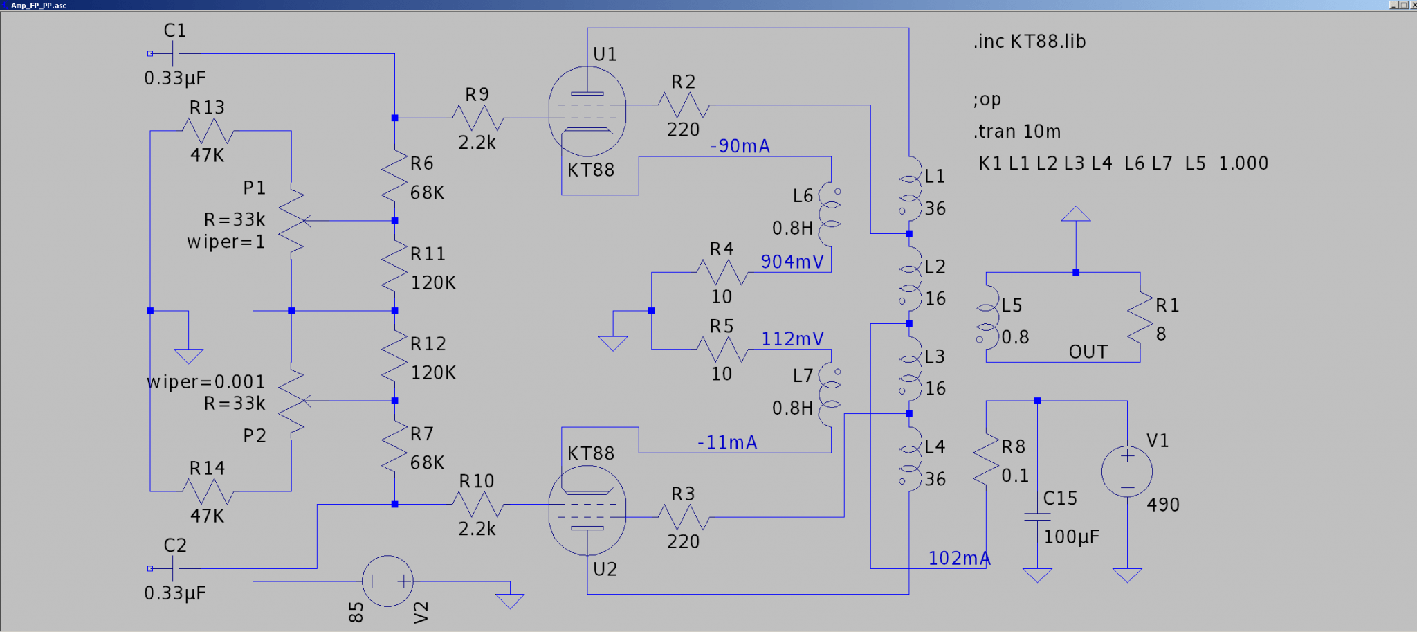

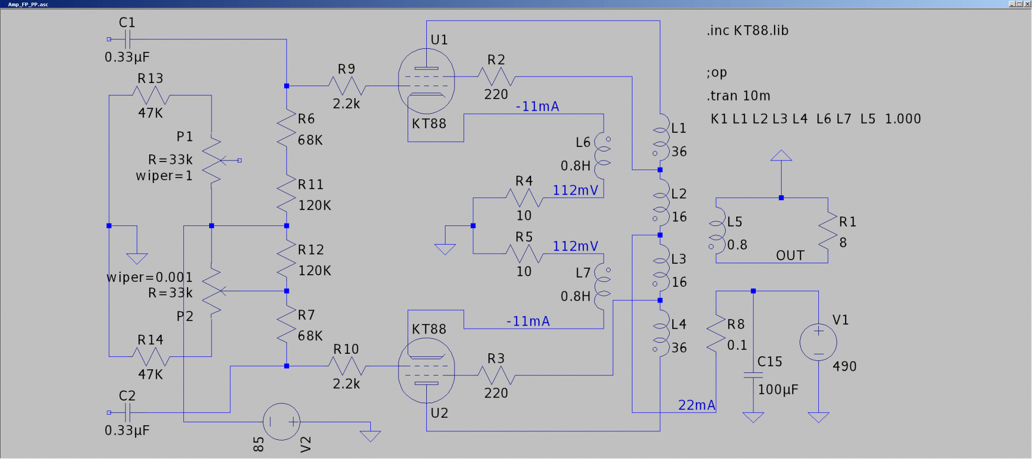

I made a foolproof fixed BIAS simulator with LTSpice for push-pull output stage (LTSpice is freeware). The idea of foolproof BIAS circuit was inspired by the Soloist amplifier designer. Even if BIAS potentiometer go south with total annihilation of the wiper, vacuum tube will not overheat and burn. Additionally, it allows to fit available components. For example, I have a box of 33K potentiometers which I would like to use for BIAS adjustment of PP KT88.
Entire archive enclosed, you will need to open *.asc file in LTSpice, edit values, types of tubes, etc., and run simulation. For output tubes other then KT88 - download, copy and include another *.lib file from within *.asc.
I changed resistors to lower values (compared to Soloist), as IMHO Soloist's grid leak final value is too high.
Self-explanatory screenshots attached. 2nd simulation is with broken wiper.
Enjoy !
