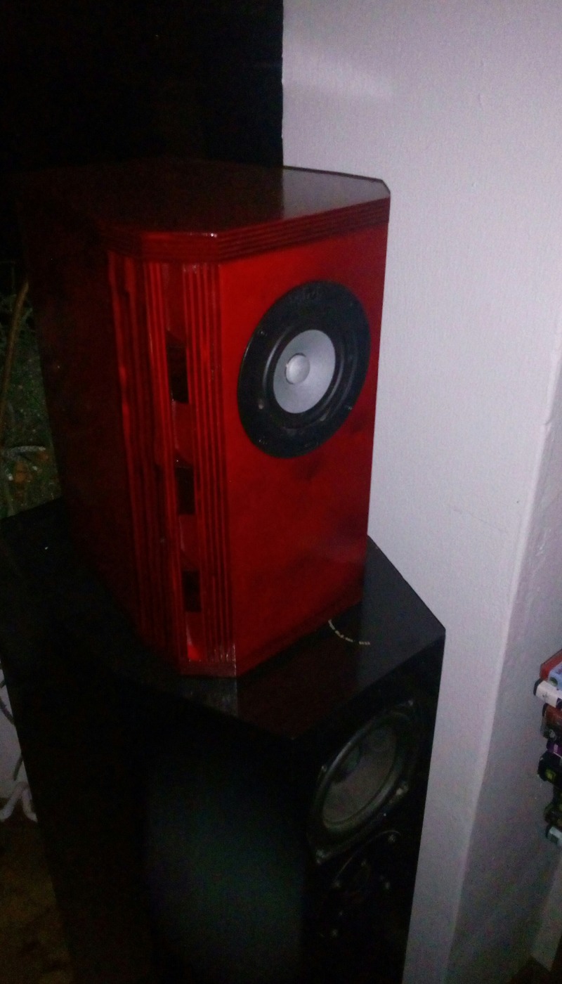

now, 4 months later, i made a pair. thänx again for the plans, dave. i like the sound and am considering to make another pair, with two drivers each. lets see what 2019 brings. i still have to build those metronomes, the drivers have been around for years ...
That is A7p? So Mar-Ken7pR. Excellent.
A twin driver version is certainly doable. Contact me when you want to do it and i’ll draw it up.
dave
dave
no, this is A6.2p from the planset you sent me, and there's a twin driver version in the plan set already.
A6.2p. I like that better than the A7p :^). mMar-Ken6pT. You may have done the 1st build of these. I’d love to see more pictures.
I have the “about the same but simplier” mMar-Ken6.2p with A6.2PeN and it is superb. Did an AB with a set of LS3/5As i restored, i much preferred the Alpair.
dave
dave
i admit the picture is not very good. i took it with my smartphone camera, and thats quite bad (Acer!). I will see if i can make a better picture these days. These boxes are for my holiday house in france and will look (and sound!) good next to the fire place. I will post more pictures.
