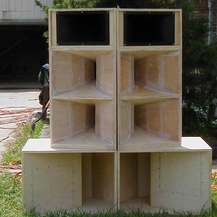

[/QUOTE]Using the 18's for mid-bass or low mids is a waste of space. I built front loaded horn mid bass bins (22.5x24x29, same as a 1x18) with Kappa pro 12's that will eat a 2x18 for breakfast above 90 Hz.[/QUOTE]
ski can you post up pictures of the mids?

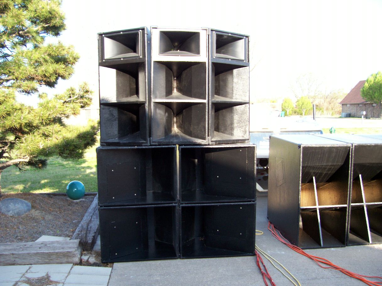

The boxes at the bottom are the low mids. Just one with only 200 watts will produce one hell of a kick. The unpainted boxes show the detail better but the completed stack is more intimidating 🙂.
nice to see a full hornloaded stack.
sound's verry dynamic i would think.
what subs are those on the right?
