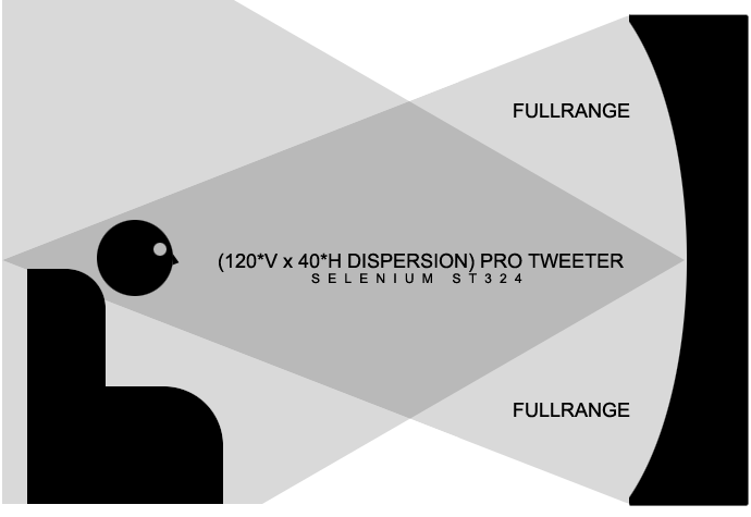

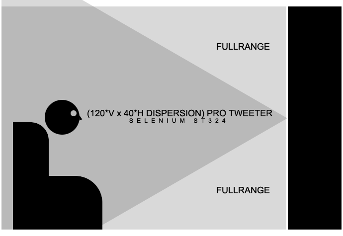

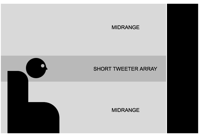

Well my line array consists of 16, 4" fullrange drivers and an short array of 9 tweeters. I crossed them over at ~6k. I have an U baffle with a 10" baffle and 4" sides. After moving, I become bored and thoroughly unimpressed by these speakers. I decided to unhook the tweeters and run the 4" drivers fullrange. After boosting the high end, I fell in love with the speakers again. The sound is so spacious and live. Now all that is missing is the high frequency twinkle. I've decided to add a single Selenium ST324 to the middle. With it's sensitivity and wide dispersion I think it will work well to reinforce the highs. I was also contemplating curving the baffle. I know this will create a sweet spot. But if I were to match the arc of the baffle, with the dispersion of the tweeter, wouldn't this give me a much larger sweet spot?
Are there any pro curved line array people? I only seem to hear negatives. 😀
This was my setup before ditching the tweeters. Please tell me why what I'm trying to do is wrong or right. Knock some sense into me if necessary 🙂

For pro sound most line arrays are curved but in a convex (outward) matter. The arrays are curved to give better coverage for the lower level seats (mostly near field) while firing the far field over the top of those seats to the rear of the hall and the balcony. These arrays are segmented so that individual segments can be angled to achieve the desired position. Several pro sound arrays have DSP controllers that can help to optimize the angular positioning so that largest audience coverage can be attained.
None, that is zero of the pro sound applications use a concave curved or focused array. A concave curved array would limit the coverage to a specific set of rows in the hall so that is a plenty dumb thing to do for pro sound.
I have always preached the many benefits of using a straight near field array for home applications as you'll get much better in-room performance. You can play with focused arrays or concave curved arrays but they are a really, really dumb thing to do even for home applications.

For 'fullrange' driver arrays you ideally want them to be convex with a radius = to the distance to the listening position, ergo the 'sweet spot' shrinks with increasing arc, so you need to sit fairly far away if you want it more than one or two persons wide.
WRT matching the arc to the tweeter's dispersion, this may cause severe comb filtering at some frequencies due to the arc being too much or too little for the listening distance, so a WG may be required.

Forget about curving the array (or power tapering) unless you are specifically looking for more point-source like character.
Keep with the fullranges boosted and use the tweeter line to fill in at a higher freq. with a first-order electrical high-pass.
Comb-filtering will be bad, but it won't really effect the average response much until at least 10 kHz.. (..and besides you are not currently having a problem with the sound.)
With the tweeter-line blended in at higher freq.s this should make the average response a bit more linear at these higher freq.s AND provide that off-axis induced "air" you want - ALL without messing up what you like about the line without the tweeters.

If you want to run full-range drivers in a vertical array, full-range,
a concave ( 😉 ) focused array curved as Greg describes is the only way you're going to have a reasonable chance of pulling it off. But you loose quite a few of the advantages of a line source in doing so, and trying to combine them with a single tweeter is just looking for trouble.

A focused array really operates only in the far field as all the drivers cover the same geometry in the vertical plane. As sqikev notes such an array doesn't have the feel of a large line array and it really can not as it justs equates to a point source.
In my opinion it would be better to equalize an straight array of full range drivers to perform over the band than to use a focused array with its limitiations.

Ok..so the curved array idea is scrapped.
😉 I would still like a little more input on my short 15" tweeter array. Would I get a larger listening area if I went with that Selenium tweeter I mentioned earlier with the 120*x40* dispersion? My listening distance is ~9ft.
The general line array theory is that the sound source is a vertical array from floor to ceiling -- or close to it.
Your tweeter array is too short to be a "real" line array. Using just one Selenium tweeter would make things worse, regardless of its dispersion. The premise that that sound reaching the ears has all mostly traveled the same distance. The distance between your one Selenium tweeter and the top most and bottom most midranges is . . 2 or 3 feet? With these types of distances you will get inter-driver interactions leading to severe lobing. Sound distance traveled is more important than dispersion of one point source.
Now, I guess, if your mid range line array is amplitude tapered, with most of the sound coming from the middle of its array, your one tweeter would get in less trouble, but the solution is less than optimum. In fact, your present short tweeter array would be better than one Selenium tweeter.

Seconded. I still reckon your best way forward would be to increase the length of your tweeter array. More tweeters. Lots more. Or junk the existing ones in favour of, say, something like 8 ribbons per side.
