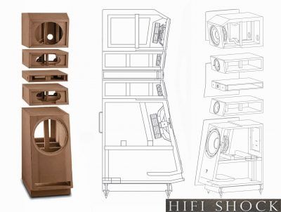

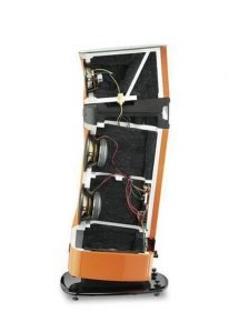

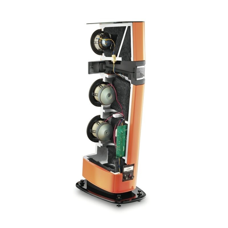

Managed to find some Focal designs online that show box construct so slowly moving forward with it.
