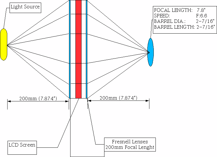

Although I'm sure this is covered some where on this forum, I did some searching and couldn't find it. So here goes.
If I understand the project right you have these parts in this order.
1. Light
2. fresnel lense (for straitening the light)
3. lcd screen
4. fresnel lense (for focusing the light)
5. projector lense (for projecting the light)
Questions:
1. some designs I've seen seem to omit the second fresnel lens...is that just an oversight, is it not nessicary or is it because of a propert of one of the other two lenses?
2. If I have a fresnel lense with a 200mm focal length, does that mean that a) my first fresnel lense should be 200mm from the light source, b) my second fresnel lense FL should be equal to the FL of the projector lense?
3. How do these lenses sound?

this 9" focal projection lens you talk about is not the best choice for 15" lcd. the most comon is 32cm focal triplet. (yours is 23cm focal that is something short, this means the corners would be out of focus).
You could use a single fresnel that has the same focal length as the combination of the two normally used, but it is not a good idea because fresnels do not work very well unless you have parallel light on the ringed side and the lamp or projection lens near the focal length from the smooth side. But sometimes you can get a pair of fresnels (ie. a 220 mm fl & a 330 mm fl) glued together, so they work very well but look like one fresnel. When you do have two fresnels, you can put them both at least 20 mm before the LCD, or you can split them up. Then the condensor fresnel goes at least 20 mm before the LCD and the field fresnel goes 20 - 30 mm after the LCD. Unsplit looks better. Split lets you do some optical keystone correction, if needed.
a) That is a good starting point, but you can adjust this distance later by a few millimeters to get the light going into the projection lens.
b) No, the LCD to lens distance will be more than the focal length of the projection lens, since your screen will not be on the moon! For a 10 foot throw distance and a 320 mm fl triplet, the LCD to lens distance would be 357.5 mm. Ideally, your field fresnel would be (357.5 + 20) = 377.5 mm fl for an unsplit design, or (357.5 - 20) = 337.5 for a split design. Either one of those would focus the lamp arc image right into the center of the projection lens. But I don't think you can find a 377 or a 337 mm fl fresnel!
Use a 330 mm fl fresnel. If you need to do optical keystone correction, then build the split design with the 200 mm fl fresnel 20 mm before the LCD and the 330 mm fl fresnel 30 mm after the LCD. If your projector can be positioned so the projection lens is at the same height as the middle of the screen, then build the unsplit design with both fresnels 20 mm before the LCD.
Once you have it together enough to project an image, you can tune the optics by adjusting the lamp to condensor fresnel a bit to get the light all going into the projection lens.
3) Have fun! 😀
