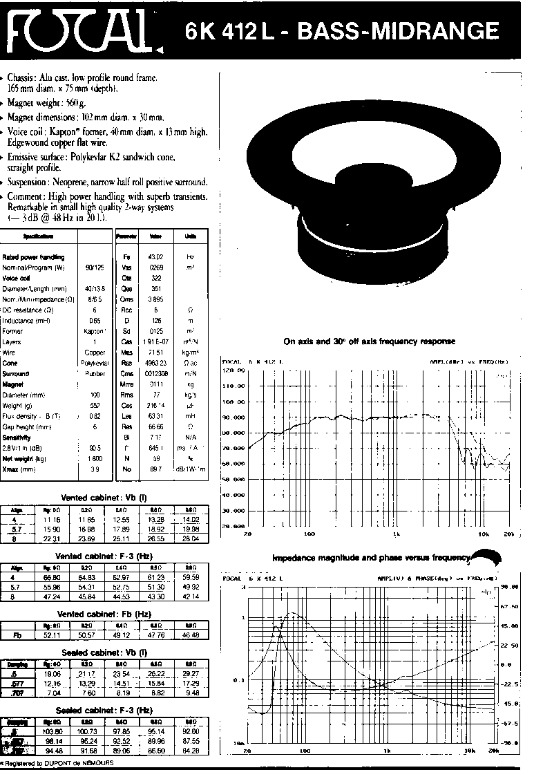

I found a pair of Focal 6K412L midbass and Vifa D27TG45
tweeters while clearing some stuff that's been collecting
in the basement for years. Unfortunately I cannot find
the datasheets for these drivers. I've tried the
manufacturers' sites but these drivers appear to no
longer be made.
Would anyone know where I find find the TS parameters for these
drivers? I'm hoping they can work together in a small two-way.
Any suggestions on how to use these drivers will be
greatly appreciated.
Thanks,
Dennis

Focal 6K412L Data
Hi Dennis,
here is something from an old Focal datasheet.
I think there is everything You want to know.
At least keeping all the old stuff is good for something😉
Sorry I can`t be of help for the Vifa .......
but maybe if I dig a little deeper in my mess still something useful will see the light of day ...respectively of my scanner😀
P.S.: In case the pic. turns out not to be readable enough - email me for a high resolution file.
